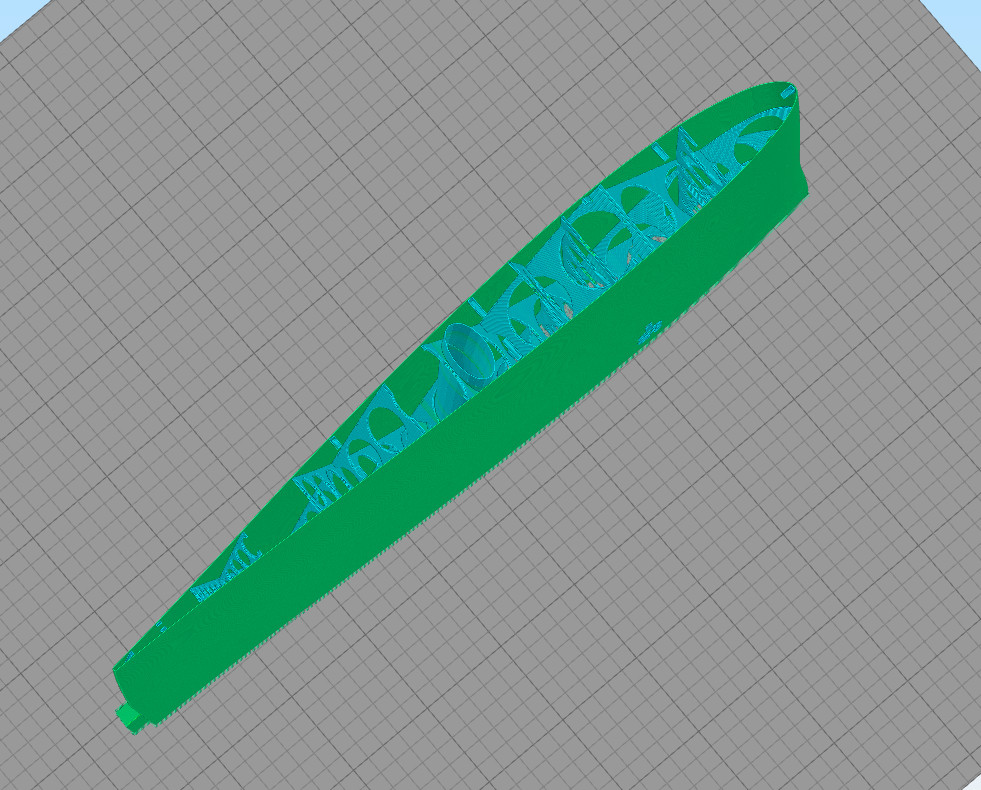

Your Thingi-File in S3D - V5
Mayk
Posts: 8
Joined: Thu Dec 15, 2022 2:21 pm
Re: Does V5 still allow for thin-wall 3D printed wings / airplane slicing?
This is a Sample from my Edge. Open as Factory file and directly sliced without changing parameters.

Re: Does V5 still allow for thin-wall 3D printed wings / airplane slicing? (update: it does)
As a representative of 3DLabPrint, I have to disappoint you. Majority of the factory files that used to work in V4 end up empty. Even with the Edge wing mentioned above, not all the internal features are there.
From my observation, the V5 works just as PrusaSlicer (and every other slicer) used to work before they made a slicing mode called Even/Odd. Back in 2014, the V4 behaviour was unique to Simplify3D and that, along with the possibility to set different processes along the Z height, was why we started to promote it as the slicer to go.
This is a pretty old thread, but yet, this issue was already resolved in our prior 5.0.1 release. You can read instructions here:
viewtopic.php?p=64212#p64212
3DLabPrint also has similar instructions on their own website. They mention that 5.0.0 didn't work with their files, but 5.0.1 works correctly with their instructions.
https://3dlabprint.com/faq/setting-simp ... nt-planes/
