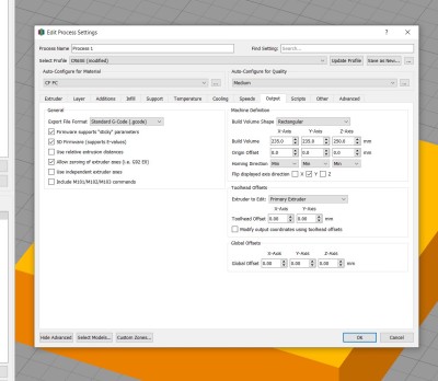

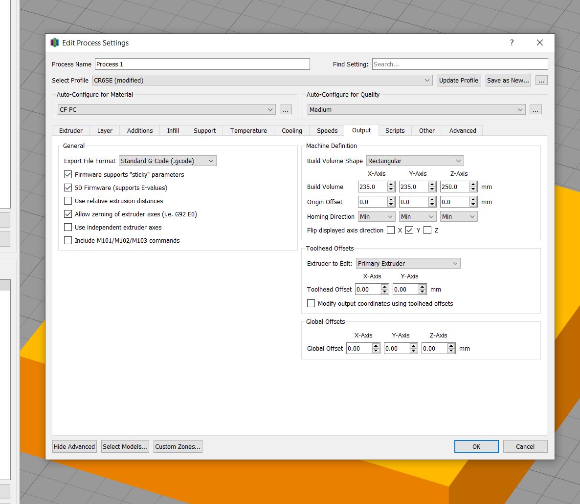

Hey you can change your build area in your print profile under output (already possible in V4).
nerys
Posts: 269
Re: Can No Longer Change Printer Size in V5?
is there. some of the taps/names got moved/changed. its now under the "output" tab.
