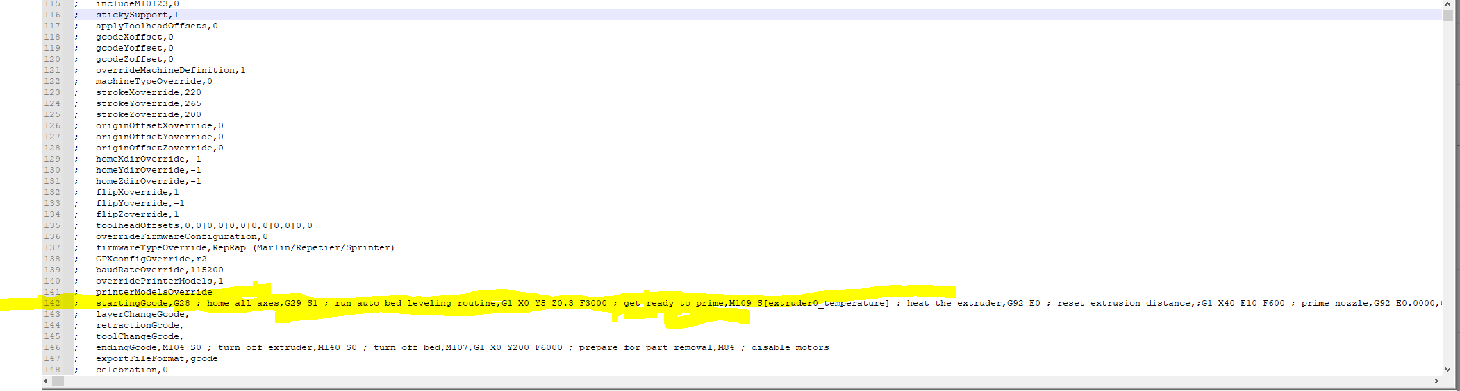

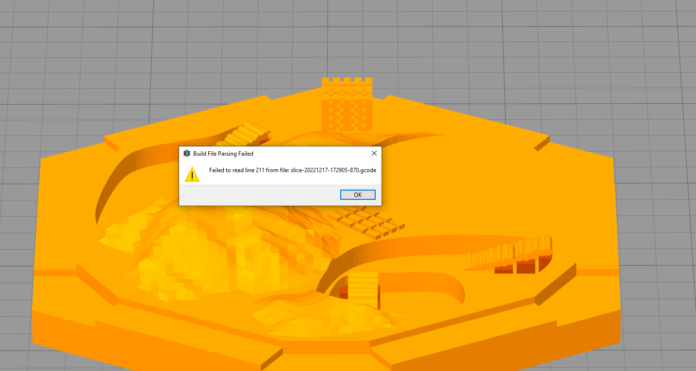

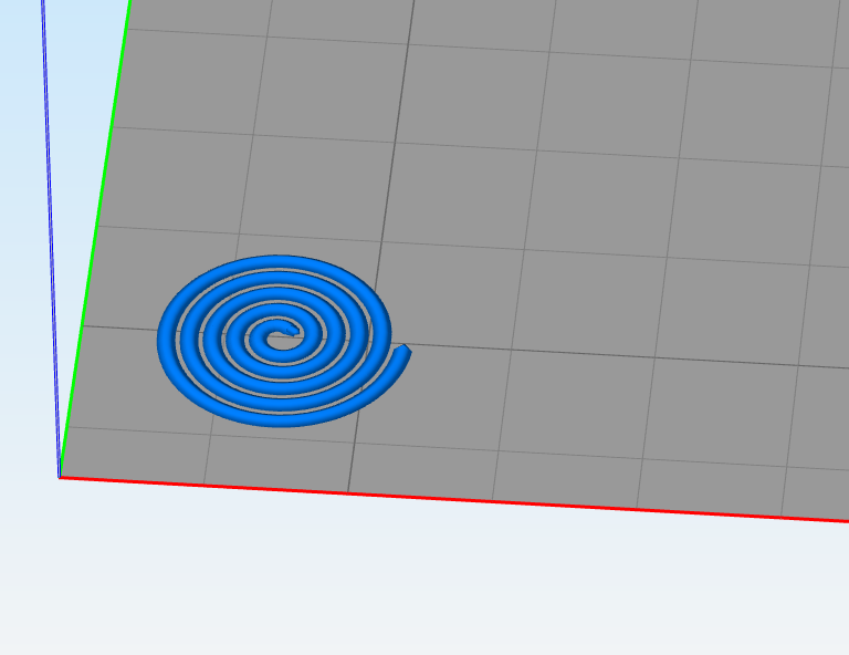

So I have made a custom spiral priming script, it's very long. This script works perfectly in V4 but V5 stops parsing g-code when it reaches that point. When i try to open the g-code file made with V4 in V5 it points to line 142 which is the start script line.
Just wondering if there is a reason for this or...

Perhaps the movements are too small? Have you tried creating a spiral with a lower resolution? That wold probably make your starting script much easier to read and I doubt it would impact the priming at all.

Take it easy there bolsoncerrado. There's no need for hostility here. But you are right, that ridiculously long line in the gcode file is easily handled in V4.
I understand that this is a fresh update and there are bound to be bugs to smash. I hope this is an issue that gets addressed in an update soon.
I guess in the mean time I will be using a more simple prime line unless i can get my machine to handle G2 codes.
