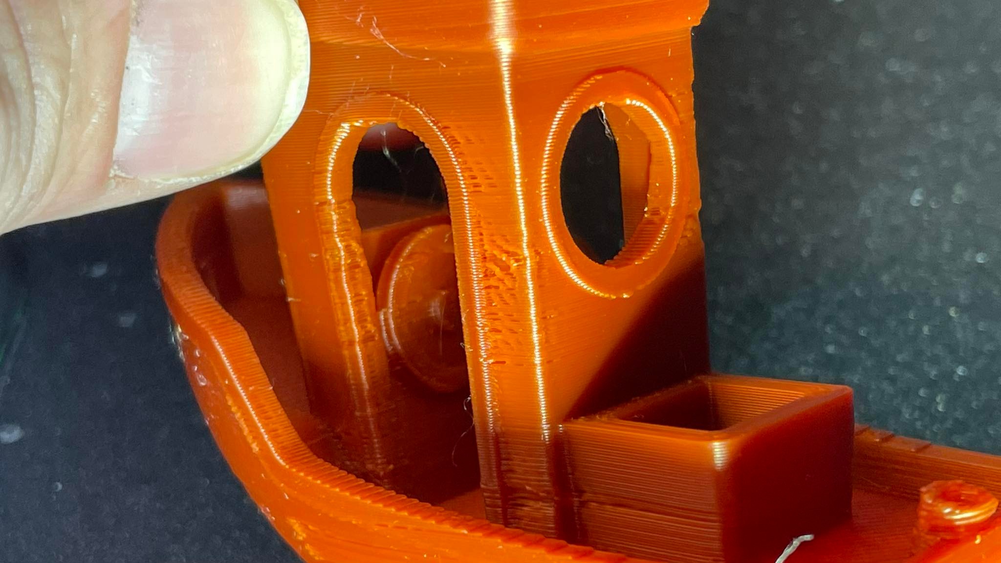

Underextrusion behind sharp corners
I am always getting this Underextrusion behind sharp corners, does anybody know why and which setting is effect this?

That's necessarily a slicer issue...that's in probably related to Linear Advance on (firmware), or not properly calibrated!

I guess you meant "that's NOT necessarily a slicer issue" right? :P

bolsoncerrado wrote: Wed Dec 21, 2022 1:25 pm I guess you meant "that's NOT necessarily a slicer issue" right? :P
Correct :)

Thomasengelmann wrote: Tue Dec 20, 2022 10:14 am I am always getting this Underextrusion behind sharp corners, does anybody know why and which setting is effect this?
Check where your retractions are, sometimes it is related to an empty nozzle after a retraction. Retract less, or turn off force retractions after each layer. If it is retraction related can add a little extra prime, "Extra Restart Distance" of about .2mm .
