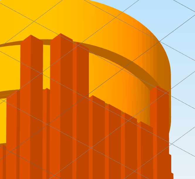

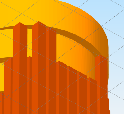

I don't think I fully understad S3D's support generation. How did it determine the most overhang part on this model didn't require supports... and the other supports all over it are just as spotty, seeming to choose when and if it bothers to put supports on a model at all.
I had to spend 45 minutes carefully placing my own supports which is way too much work when there are other slicers out there doing it perfectly the first time. Prusa had no issues supporting this model beautifully, but S3D has the superior quality and tolerances. With so many slicers out there making perfect supports, some of them open-source, I'm not sure I understand how S3D is continuing to miss the mark on this.

It might help to lower the size of your support pillars. They look a little large for that ledge. For example, instead of using 4mm pillars, try 1-2mm in size.

S3D-Jason wrote: Sat Dec 24, 2022 3:03 pm It might help to lower the size of your support pillars. They look a little large for that ledge. For example, instead of using 4mm pillars, try 1-2mm in size.
I tried that, it was bad for all possible options, I tried everything from 1mm to 4mm and every single time it missed large patches of overhangs seemingly for no reason.

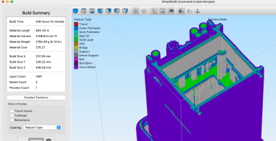

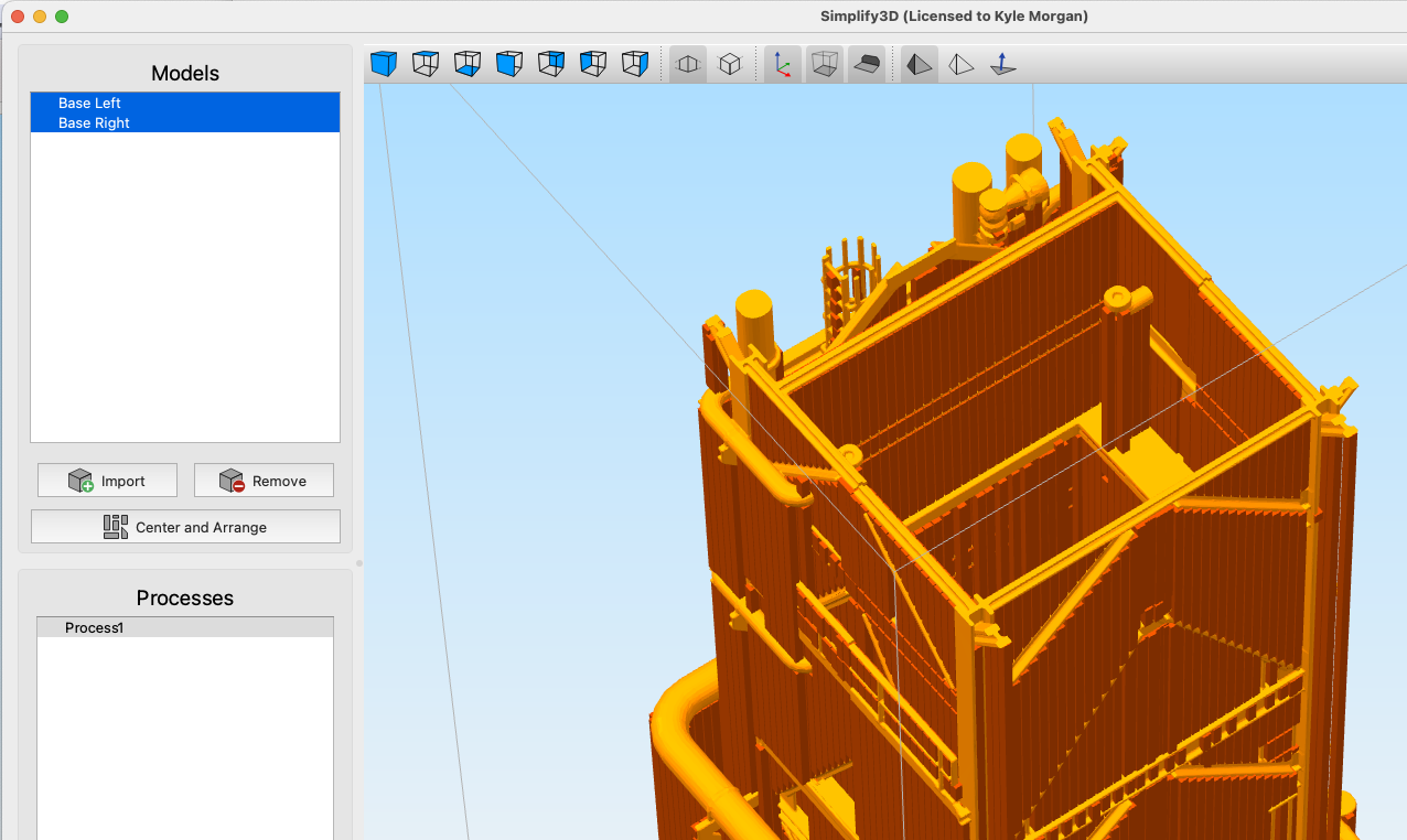

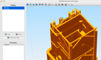

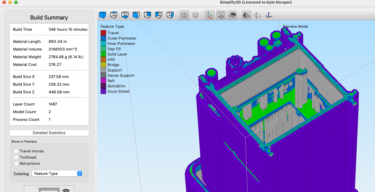

I would agree on the mostly miss part. I'm unable to add manual support in some areas (can add all around but there are random places where v5 just won't let me add any sort of support).
I've also noticed that a lot of supports that I've manually added don't show up once the model is sliced. The software removes most of them. I did not catch until I had a failed print because of missing supports and was able to reproduce what happened. See attached screenshots. The ones removed weren't even manually added.
