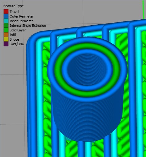

There is a feature to reduce the speed for short perimeters and it works great. Unfortunately if you have the Thin Wall Behavior > Internal Thin Wall Type set to "Allow Single Extrusions" any "Internal Single Extrusion" within the short perimeters will print at regular speeds. The movement of the extruder is of course trying to print the internal single extrusion at regular speeds, rather than the Short Perimeter speed limitation set in Speeds > Speed Overrides > "Reduce print speed for short perimeters". Because of this the perimeters print, internal and external, but the internal single extrusion that fills the chimney walls of the benchy do not fill.
Since it is not considered as a solid infill (it is a separate feature type) it's speeds are not controlled by the speed settings in Speeds > General > Default Printing Speed > Solid Infill Speed. You can of course change the setting to perimeters only. But some layers don't allow for a perimeter to fit in.

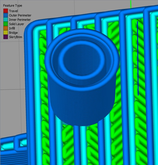

Shown in picture layer 222 you can see the chimney of the benchy is hollow. Because "allow single extrusions" is off. When you turn it on those layers are filled with internal single extrusions. But because they're printing at regular speeds they don't extrude.
I was wondering if yalls could put in a feature to reduce the speed for Short "Internal Single Extrusions". Version 5 already identifies them as a separate feature colored dark green. It would have the same setting options like the setting for "Reduce print speed for short perimeters"
