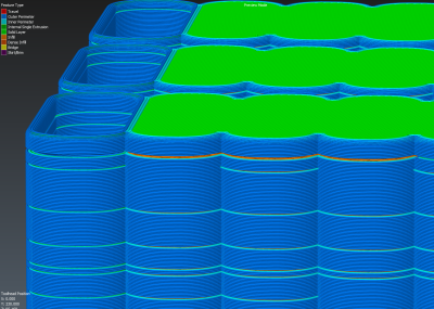

Ok, I upgraded today to 5.0.1, no changes to my usual slicer settings and this is what happens. I'm printing an USB cable holder, that should look like this:
The result after slicing looks like this:
Here's the .stl file (from thingiverse, option 6/small):

That's what Cura delivers:

What is the printer? I had similar issues which I have resolved.

Try this one. It had a ton of errors in the file.
At first it failed but then started working. I tried several printers and it is ok.

Just for reference, the original STL file doesn't appear to slice correctly in 4.1.2, 5.0.0, or 5.0.1 so I don't think this has anything to do with the 5.0.1 update. The original STL has a lot of mesh errors, but the repaired file wirlybird posted above seems to work!

I ran it through Netfabb.
