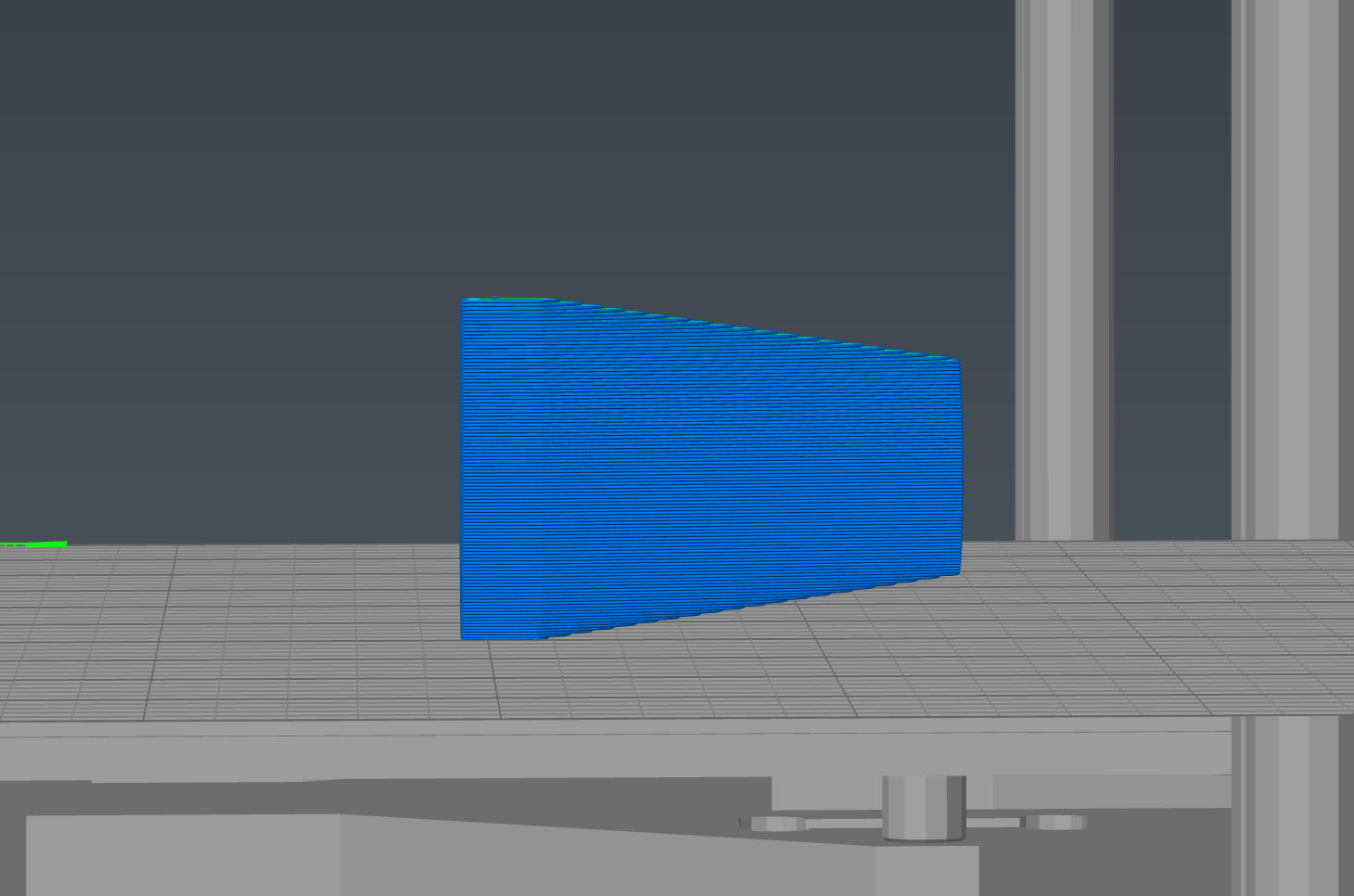

I've printed THOUSANDS of this piece on the SAME printers with S3Dv4 flawlesly.
Well here you have the results with v5 gcode. Lame at its best!

I mean it's exactly as in the review, so why did you print it at all this way?

Since Ive printed it countless times, the print above was an overseen duplicate plate print I sent. i never expected v5 to f*ck it up!!! so i sent it blindly.
The screencaps were just captured afterwards to illustrate the issue.
As i said, I never had problems printing this with v4 in the past. SAME EXACT PIECE. NO MESH ERRORS.
