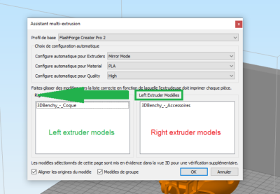

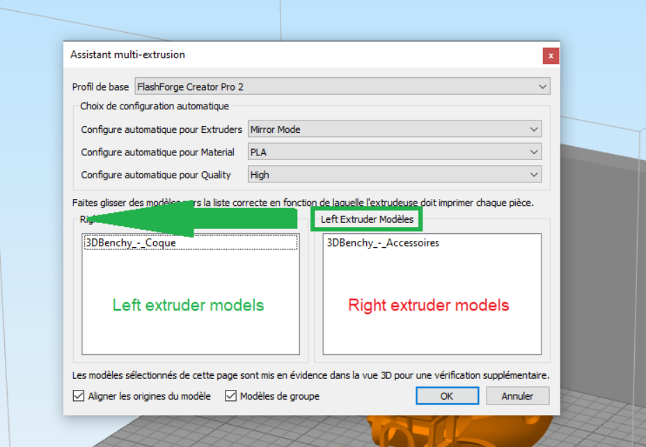

1. Multi extrusion assistant
I don't know if it the French language application witch is the only impacted, but I think it would be more intuitive by ordering Left extruder on the Left side menu and the Rigth extruder on the Right side menu !
Multi extrusion assistant left/right change example

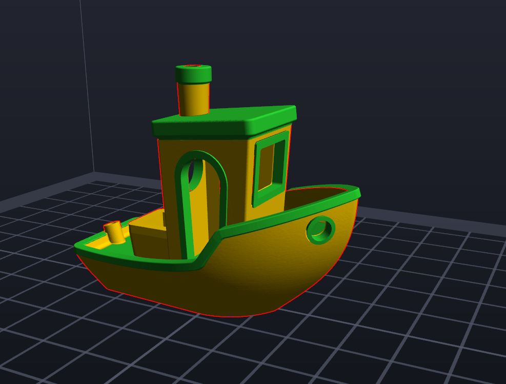

2. Extruder coloration
Model's color could be identified for each part of models printed by each extruder...
For exemple, in FlahForge's app Left extruder is in dark green and the Right in dark orange.
Extruder coloration example from FlashPrint

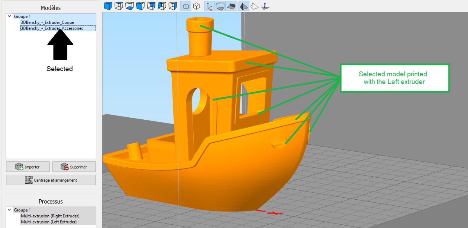

3. Model's part selection
When dual print helper's group is crearted, I can't identify whitch part of model is printed by the right or the left extruder...
If I want to select one part, all item's from the group are selected !
It would be more intuitive, like my precedent review, that each item is identify by an extruder color.
Unable to select one model part

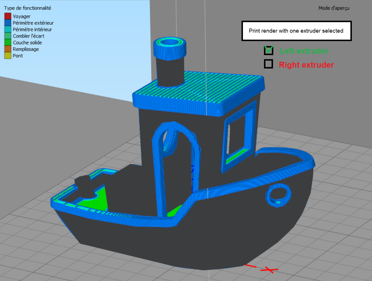

4. Printing rendering
Finally, we would be able to select each extruder from the construction view, to inspect extruder.
When we select an extruder, only these parts are shown in bright light, other parts switch in dark light.
[I'm not able to attach another picture here !]

For #1, I believe the order in the multi extrusion wizard will match the order you used in the profile. So if you want to have the left extruder come first, make sure that extruder is listed first on Edit Process Settings > Extruders tab.

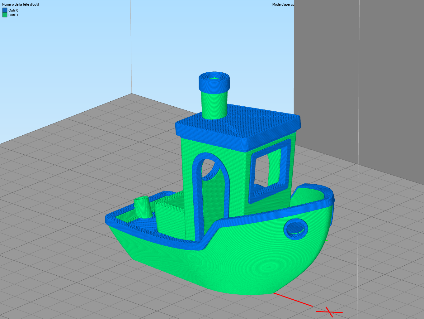

For your suggestions about model color, I know you can already select "Active Toolhead" in Preview Mode to get separate colors for each tool. Does that help with the #4 suggestion?
Thank you S3D-Jason for your responses !
For #1, you're right, the Right extruder came at first because it's registered on head tool #0... I will change the settings order, thanks !
For #4 suggestion, I think it would be interesting to be able to see selected tool like this, with a mask :
Preview with selected extruder example
... but I found the option that you said about the "Active Toolhead"
Active Toolhead Preview
Thank you S3D-Jason !
