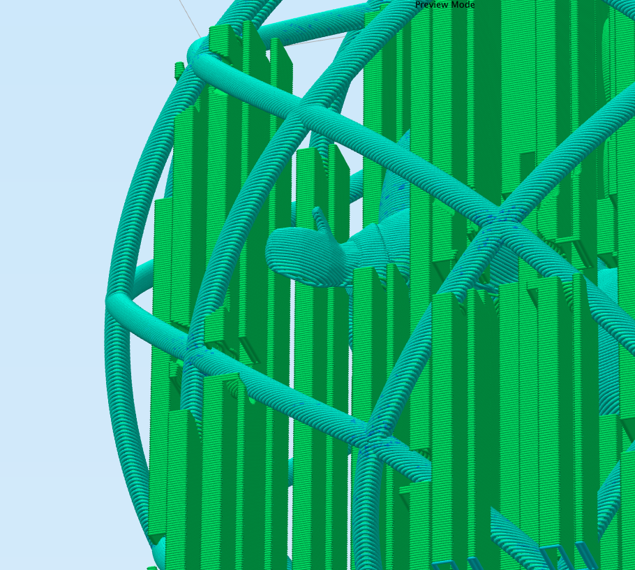

I tried printing this one : http://www.thingiverse.com/thing:5254
But it generates impossible print, with automatic support generation. I have attached a picture, showing the hand is not supported and it starts printing in mid-air.
I could make sure averythng was OK manually, but it would be nice with some warning saying this print would 100% surely fail.
/Per
Re: Missing support
you need to turn on the support inflation distance. 1mm would probably be enough for that.
