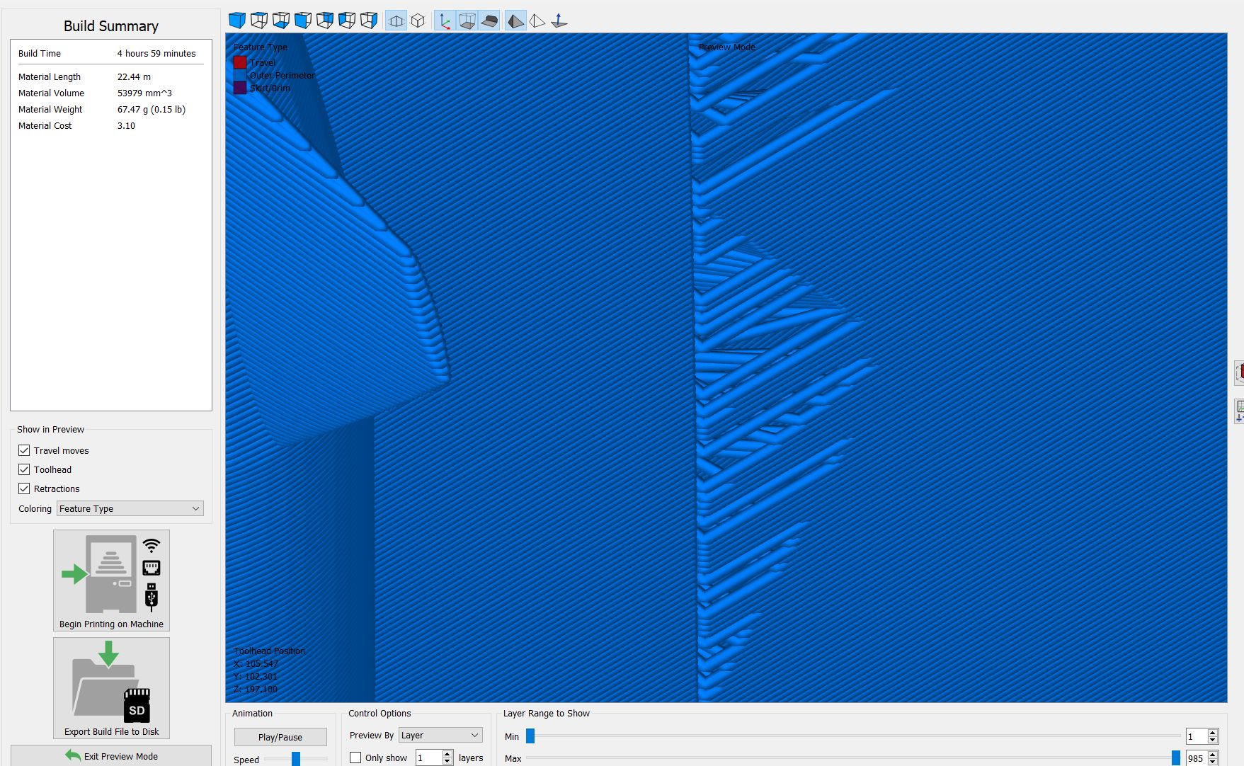

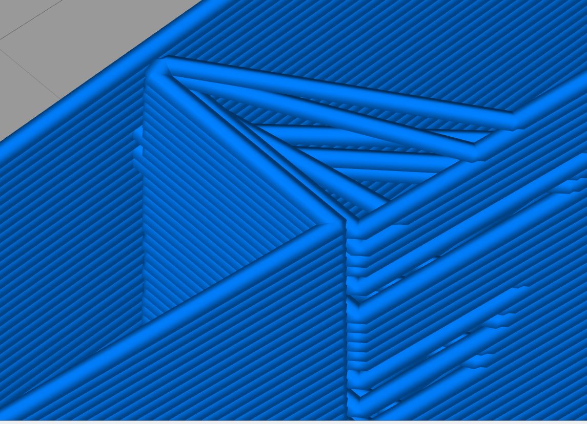

anyway. sometimes s3d just BUTCHERS the slice. little sections of wall "out of place" sometimes these are minor and can be ignored. sometimes just ROTATING the model is enough for the slice engine to "see" that section differently and go around the bug so to speak. otherwise it just butchers it like here (the print worked but was pretty nasty)
Well I figured out what is pissing off s3d (btw slicing it in prusa slicer zero defects I am not sure if prusa slicer is correcting an issue better or just not freaking out about an issue)
SO I fixed it in s3d. I "scaled down" that fin set for a small fuselage and smaller print volume Well that 0.01mm "cut" to make that rib also SHRANK as I shrank the model. its still their but tinkercad now reports it as having 0 width (ie smaller than 0.01 the limits of its display resolution) Prusa correctly still see's the slit (which can technically be any dimension even 0.0001 to remain compliant) but it seems this near 0 dimension pisses off the s3d engine just a wee bit and it throws a fit and does this.
I went back in and thickned the "cut" back to 0.01 and resaved and s3d sliced fine. Problem is there are some models where I can't "adjust" for s3d's needs. so stuck with those unless this can be fixed.
If you need stl or factor or gcode let me know. not "world ending" problem since I do have a sort of work around for it though it does it in other places I can not explain and can't work around those not to this extent usually.
