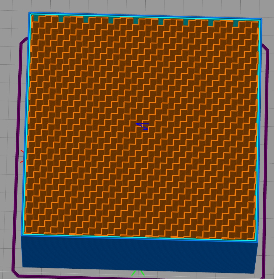

I'd try wiggle rotated 45 degrees, see pic. If the infill shrinks the pattern should stretch out instead of pulling sides in.

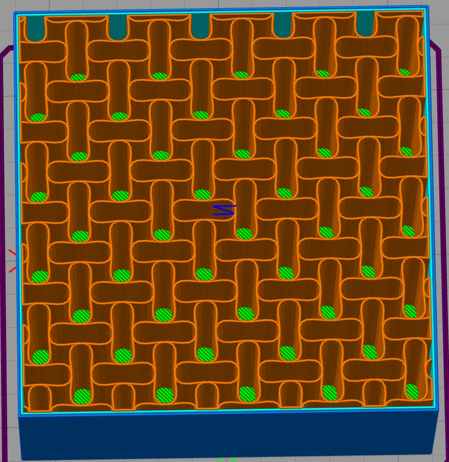

Sinusoidal would be similar as the "tubes" should deform before distorting the outer shell.

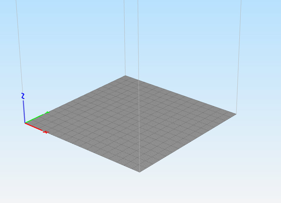

If I scale the part to 75% and use 50% Gyroid infill this is what I get. No image even though it seems to slice.
Anything higher on infill and it just shuts S3D down.

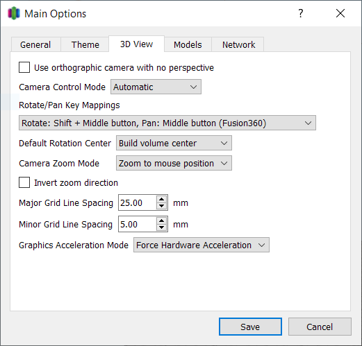

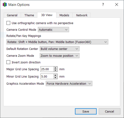

Have you tried changing S3D's Graphics Acceleration Mode options?

Just tried all three modes and it made no difference. Thanks for the suggestion though.
