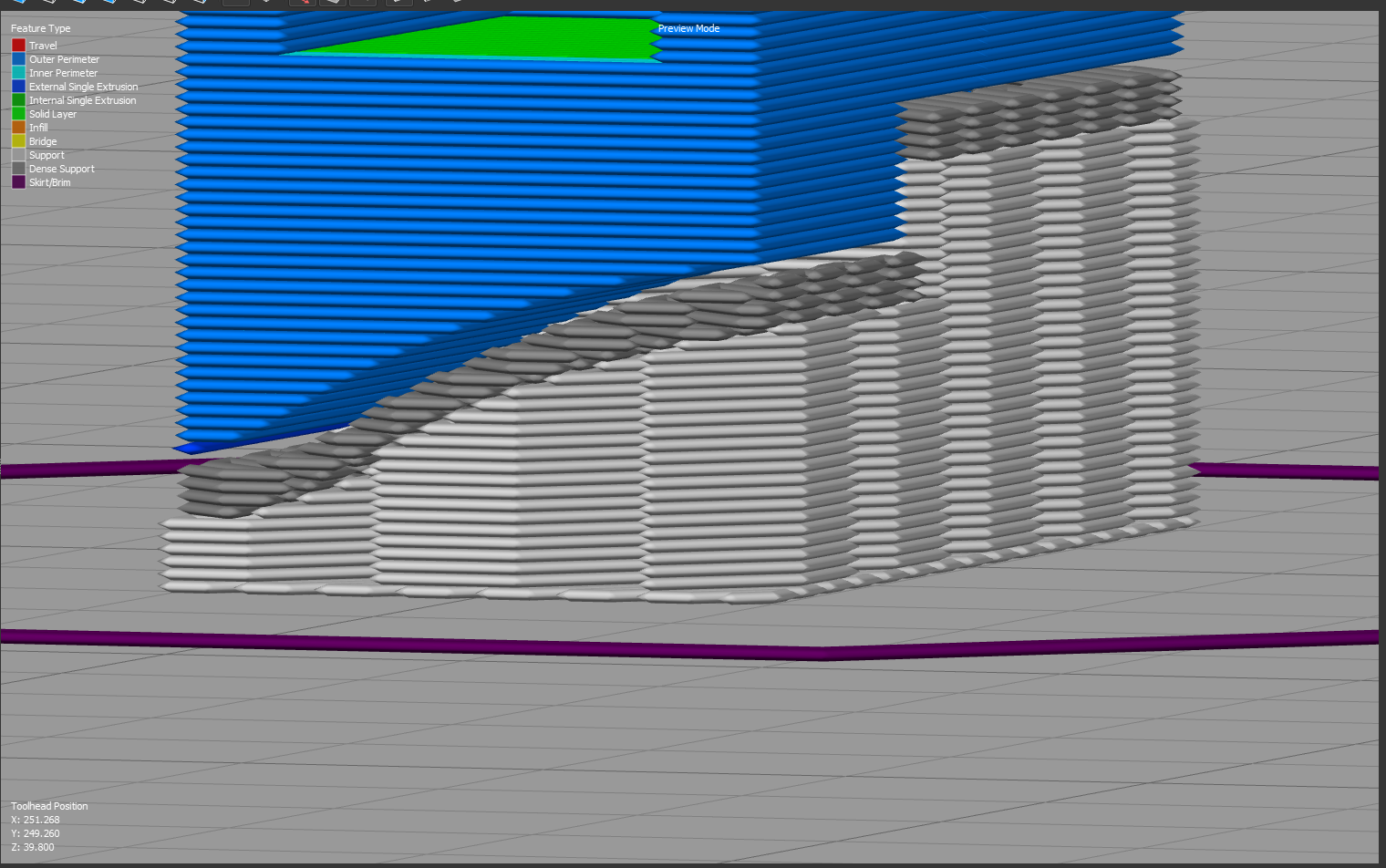

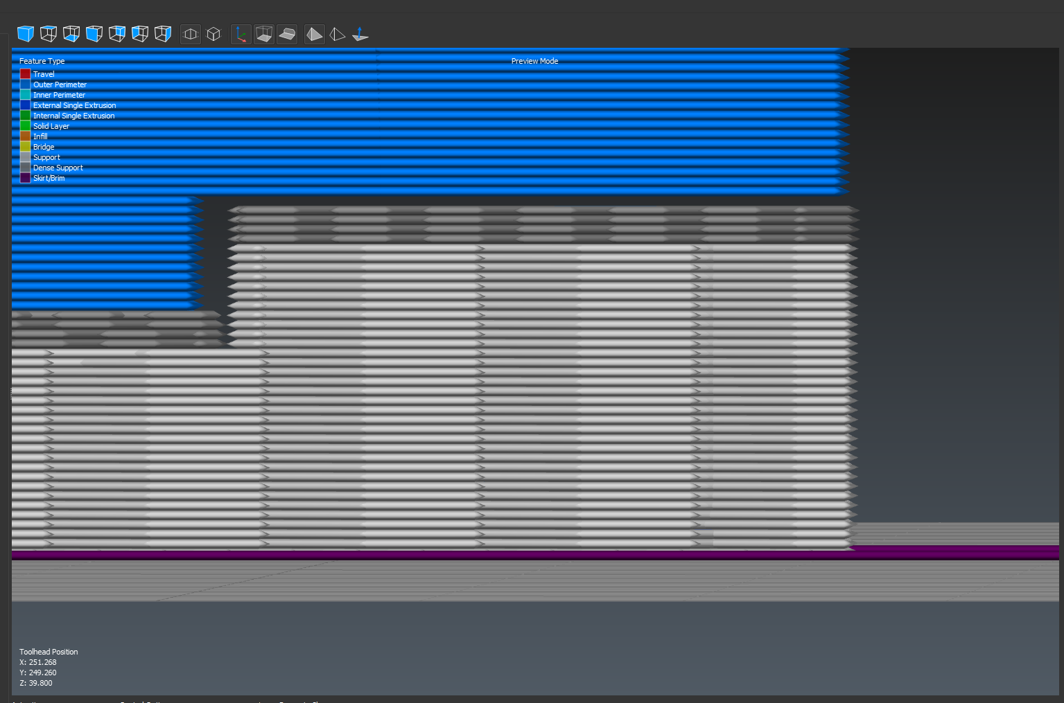

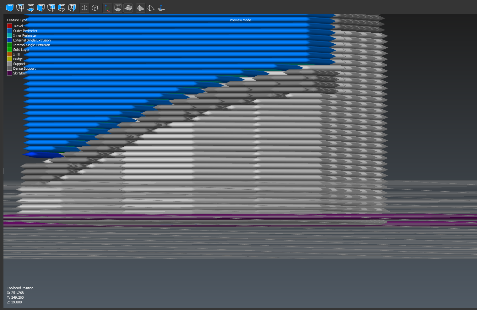

Here are three pictures to help understand what I am talking about. The first picture shows zero horizontal offset and shows a nonplanar surface with a proper 1 layer gap. The second and third picture demonstrates what happens when a nonzero horizontal offset is applied (In this case 0.6mm) and the large gap that occurs between the supports and the nonplanar surface. And the last picture shows how a planar surface is unaffected by a non zero horizontal offset.
The software in it's current state makes auto generating supports on a model with nonplanar surfaces requiring support, impossible. Any model like this must have a zero horizontal offset and then the supports must be manually applied. If not many supports will be created too close to any vertical portions of the model and will permanently adhere to those walls. So you either have to manually remove potentially hundred of supports, or manually apply potentially hundreds of supports.
The software should be able to detect when a non planar surface is being supported and ignore the horizontal offset in those areas so the proper requested layer gap is created (typically one or two layers).
