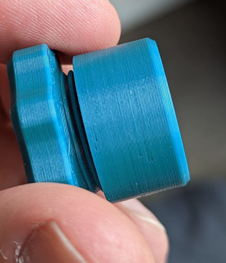

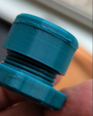

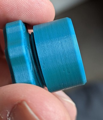

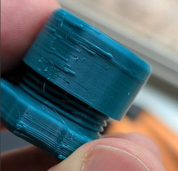

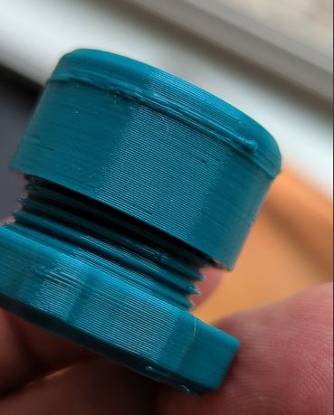

I have spent hours chasing down these weird surface blemishes
In frustration I went back to V4.1 and they disappeared so literally went item by item to figure out what setting might be causing it.. and it turns out, after hours of printing the same object with just about all the settings I could think of changing - it is when I use cubic infill, if I change infill to say rectilinear with no other change the blemishes disappear and it prints nice again!
I'm not using any crazy settings, 2 layers all over, 25% infill, and like I say if I print with V4.1 its a nice smooth finish without those weird extrusion lines that are protruding out from the surface
I need to test further but it looks like the setting "Modify travel movements to avoid open spaces" is also adding some similar blemishes but not to the same extent, I started out with them both on.
I am printing perimeters outside-in so even if the infill was going into the perimeter a bit too much it still shouldn't be making those sort of blemishes I wouldn't have thought.
Is this a bug with Cubic? I haven't tried the other new infills to see if they also do it.
The part is Thread_Test_2_x1_Rev1.STL from a voron test prints here https://github.com/VoronDesign/Voron-2/ ... est_Prints

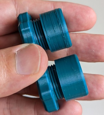

It's a custom Delta, normally can print pretty clean prints - never had that sort of a blemish before
Here is a pic using rectalinear infill instead.
I'll try again with the 5.02 update when I get a chance.

Upgraded to V5.02

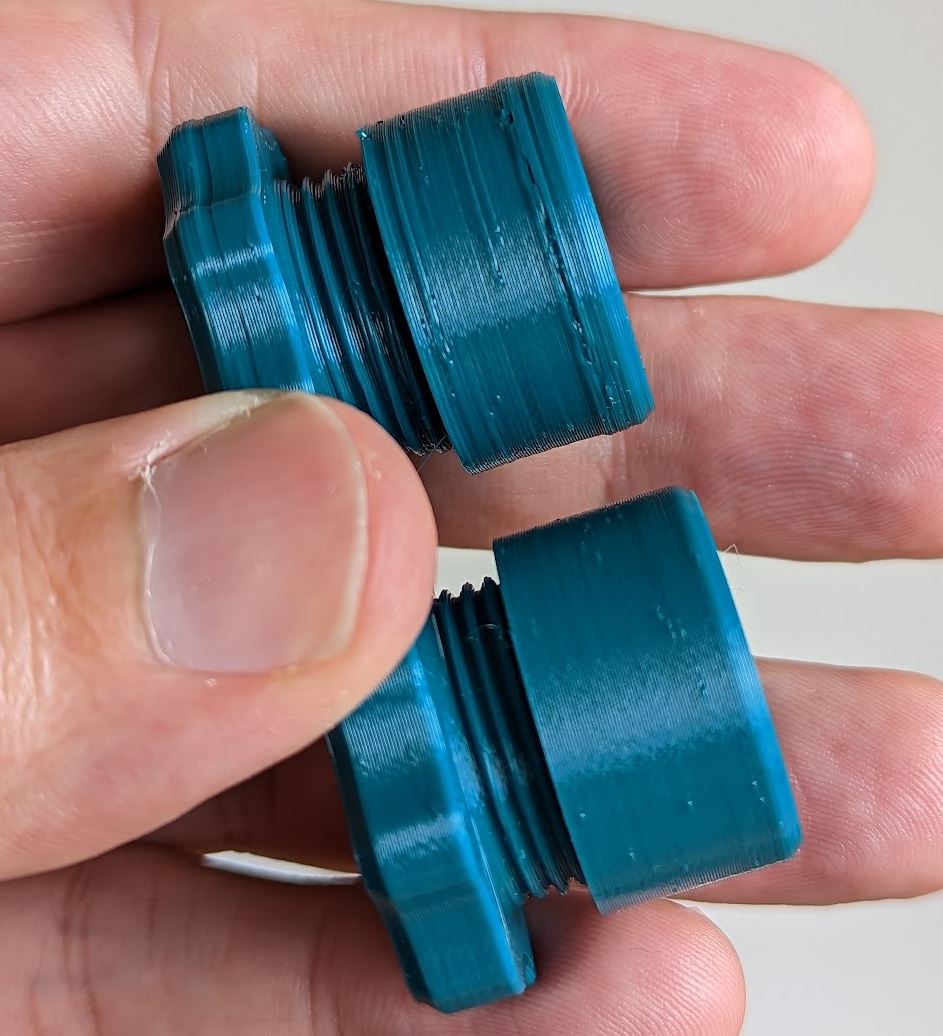

here is 2 prints I just did now, straight after each other
It's the same Delta printer I have never had any troubles with in this regard and have done hundreds of hours of printing on it slicing with S3D V4.1
The exact same settings on both prints in the pic with only 1 change, top one in pic is the new Cubic infill, bottom one has Rectalinear infill
So no improvement or fix in V5.02 unfortunately.
