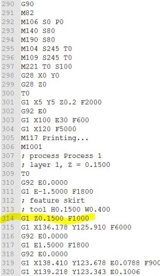

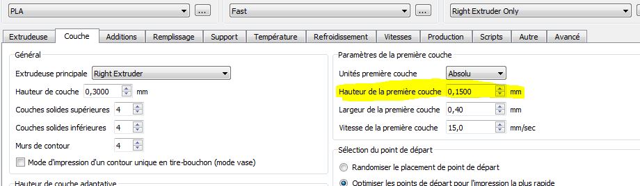

I want a first layer of 0.15 mm in height and it' ok in Simplify GCODE (please see attached images)
My question is :
in fact my first layer is at a height of 0.2+0.15= 0.35 mm !!?

If you change the first layer height to an absolute value of 0.15mm, it will only extrude enough material to fill a 0.15mm tall layer.

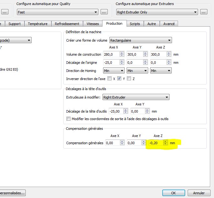

If you actually want to create a 0.35mm thick layer, then you should set the first layer absolute height to 0.35mm and use the global Z-axis offset on the Output tab instead to adjust for the 0.2mm thick sheet of paper leveling. Enter a value of -0.2mm for the global Z-axis offset and it should shift the Z coordinates downward, but still extrude the correct amount of plastic.

- If i want to use "absolute" first layer : 0.35 mm , I have to modify the global Z-axis offset on the Output tab at -0.2 (see attached images) to adjust for the 0.2mm thick sheet of paper leveling. The extruder will deliver the correct amount of plastic
