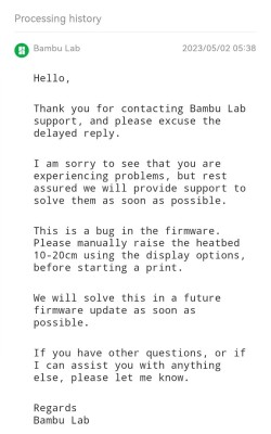

My ticket is still in progress and for some reason I can't copy the text to paste it here, but here was their last reply.

Interesting. I wonder why we don't hear it on our machine. Perhaps it only affects certain firmware versions or certain types of prints?
