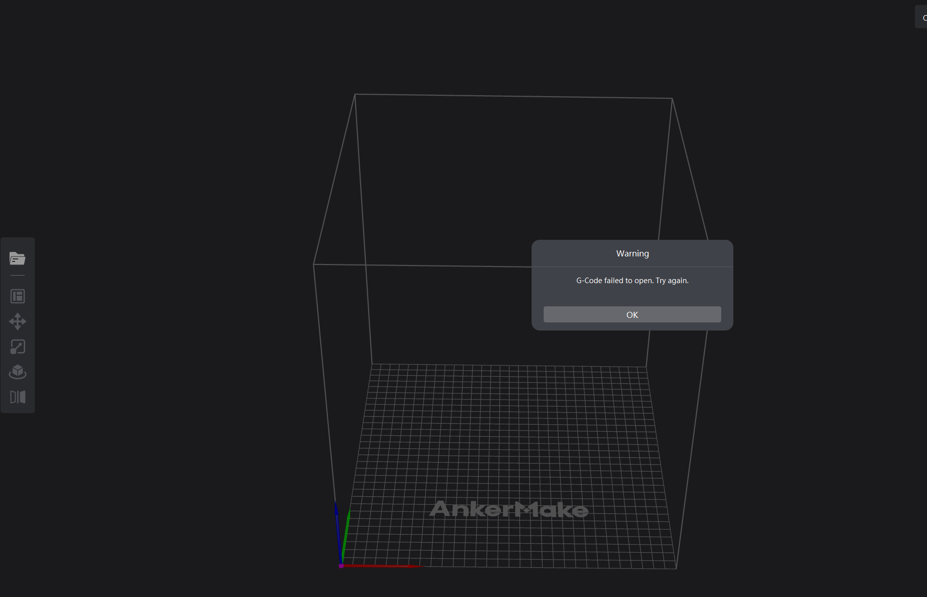

Load Simplify3D gcode in AnkerMake software
It seems that AnkerMaker slicer 0.9.32_5 no longer allows to load g-code generated by Simplify3D latest version 5.0.2.
AnkerMaker slicer seems to be looking for specific comments see example below
If I remove the following comments, the g-code cannot be loaded:
;LAYER:0
;AnkerMake
This makes it impossible to send the g-code to the printer from the PC.
The g-code works if it is copied in a thumb drive and connect to the printer so it is clearly something the did in Slicer.
Adding the comment at the end of program is not difficult using S3D -> Scripts -> Ending
The problem is the comment on layer change. Is there a macro we can use in S3D -> Scripts -> Layer Change
Something like the following where S3D replace the macro with the layer number?
;LAYER:%layer_number%

You can use the [current_layer_number] placeholder variable

Thank you, your suggestion outputs the correct comment with the layer number, but the AnkerMake Slicer still refuses to load the g-code.
I am waiting for Aker support to respond why they crippled their Slicer.
Unfortunately the error does not say exactly why it cannot load the g-code.

On reddit user StoicKiwi found a work around:
In the AnkerMake slicer instead of loading the g-code from the tab "Slice", click on tab "My Device" -> load from My Computer, the Slicer still displays an error upon loading the g-code but it allows to print.
Using this approach you lose the model preview but at least you can send the g-code to the printer
Hope this helps others.
