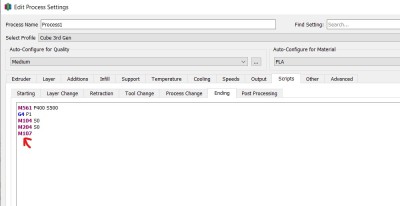

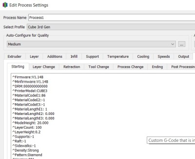

Hello, when save a print file as BFB file type S3D v5 is copying the last line of script and placing it at the beginning of the print file. This will result in an error unless you manually delete this line every time. I reported this to support email but did not receive a response and it is not fixed in the latest update.

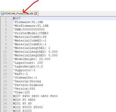

M107 being placed at the beginning of the print file is a bug, new to V5, and should be easy to resolve.

The software will typically set the fan speed and extruder/bed temperatures at the beginning of the print file. That is intentional and it has been that way for a long time. I just exported some sample files from V4 and they have the exact same commands at the top of the file. The first few commands in the file were:
G90
M82
M107
M104 S190 T0
If you want to get rid of the M107, just add this to your post processing script:
{STRIP "M107"}

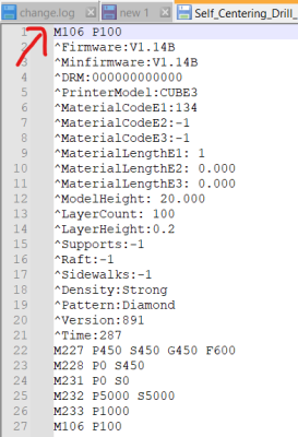

On my new device, the command injected at the beginning of the BFB file is P106 P100. *This can't be stripped out, I have to manually edit this every time I choose to use V5 over V4.
So clearly something is wrong with the way S3D handles BFB in V5 vs. V4. It's either adding a random line of code at the top or not stripping out everything above the 3DS header.
This should be easy to replicate and then correct because it worked without issue in V4.
