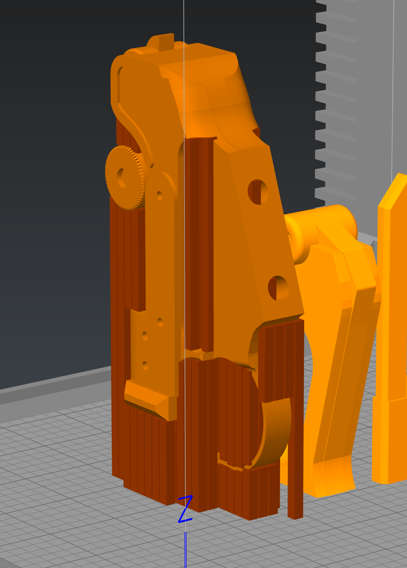

Scenario:
1) Open a v4 or v5.x .factory file
2) Assign a NEW v5.1 profile
3) Models loaded ALREADY feature support placement (check first attachment)

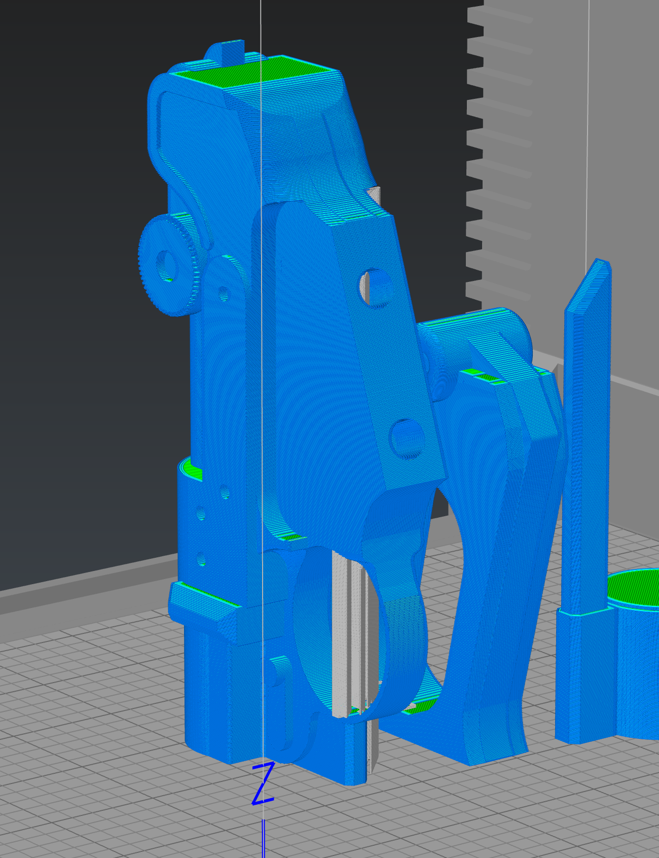

4) Upon slicing, only SOME supports show up. (check second attachment).
In order to get ALL supports I *MUST* generate them again!!
It wouldn't be a big deal if I would only have a handful .factory files.... but I have THOUSANDS! :(
This has been happening since the first v5 release and still remains unsolved.
Re: v5.xx - Supports not carried on.... completely!
Please attach an example factory file that shows this issue. I did a few tests on my own, but wasn't able to reproduce it from your description and screenshots alone.
