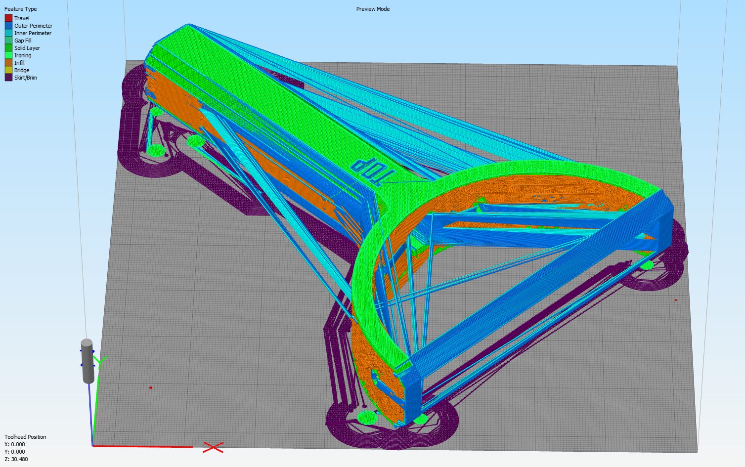

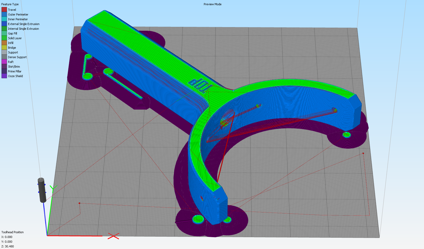

V5 no longer interprets G2/G3 as arcs when previewing build files
When using File>Preview Build File to look at .gcode files that have been post-processed with ArcWelder, G2/G3 commands are interpreted as straight lines, not arcs. This did work correctly in V4.
V4.1.2:
V5.1.0:
