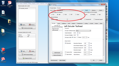

I think it would be useful to have more presets for materials then just 4. Most people can't print nylon, and most people probably shouldn't print with pva. A drop down style selector would be nice with the ability to create you own presets. There are many new materials available now, t-glase PET+ PETG XT, 618 and the likes

Wow that was easy. I will list the few steps 1 took for this.

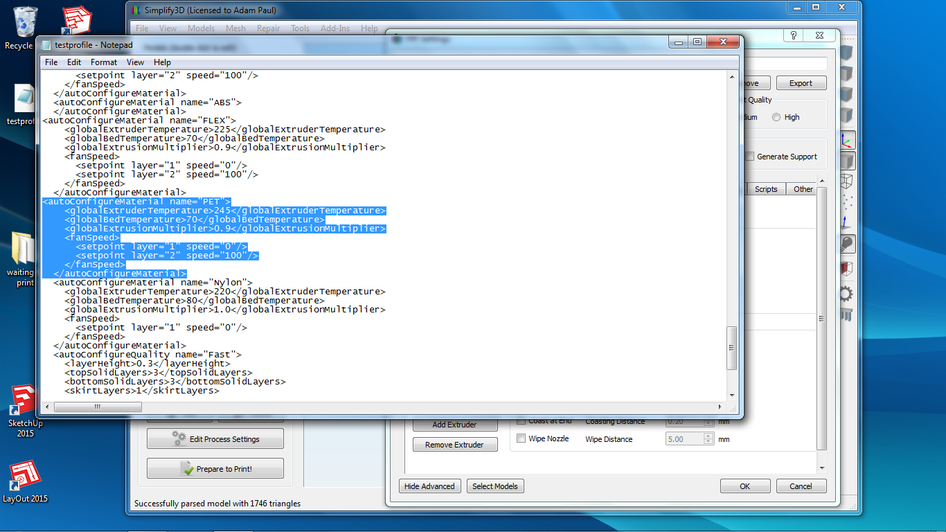

1) Edit process settings -> export . I saved a testprofile name
2) open saved file with notpad

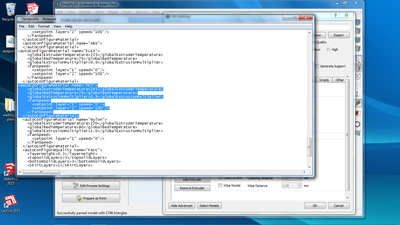

3) scroll down untill you see the <auto configure materials>
4) since i will never print with PVA ( it is glue after all) i just changed the name to PET, and adjusted the temps and extrusion multiplier
5) I wanted to add a 5th material, I highlighted a complete section of material and copied, changed name, temps, and multiplier.

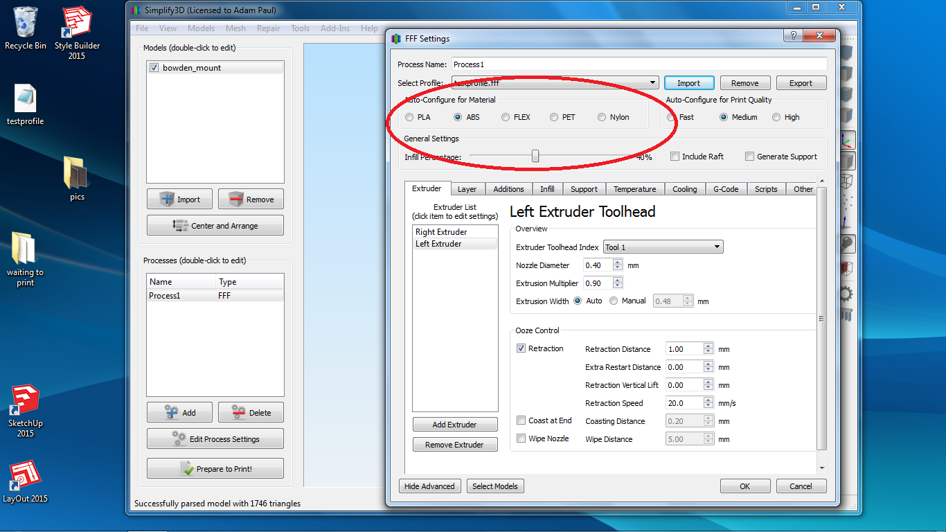

6) restarted s3d, and profited

Re: Multiple Materials Pull-down
As of version 3.0, this can now easily be done through the GUI. Just click the "+" button beside the material drop down list and enter the name of your new material.
