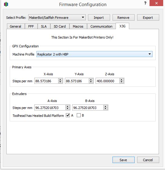

It sounds like you did things correctly in the Temperature tab, however one thing that's really important to change as well is to go to Tools-->Firmware Configuration and then select Replicator 2 with HBP

After adding a temperature controller for the heated bed, try going to Tools > Firmware Configuration.
Then in the X3G tab, instead of Replicator 2, try the config for Replicator 2 with HBP

Thanks to both of you. That did the trick..........but there is an issue I think !!!
