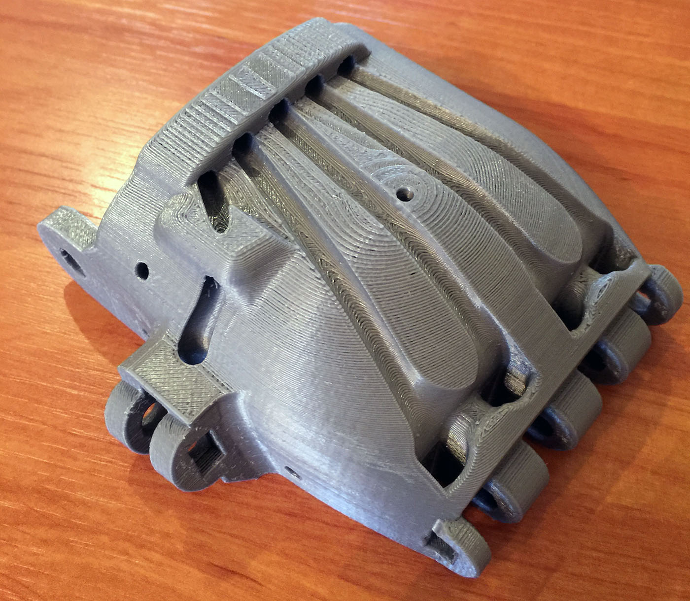

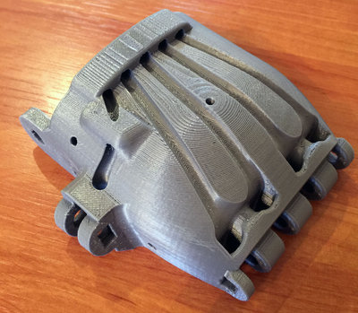

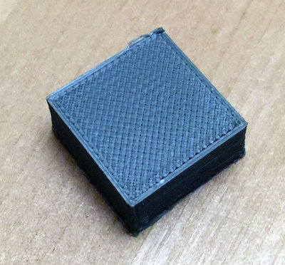

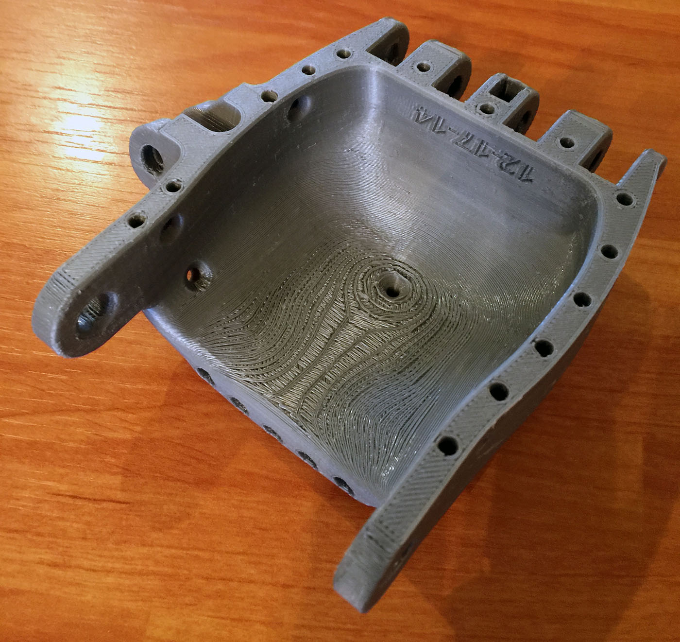

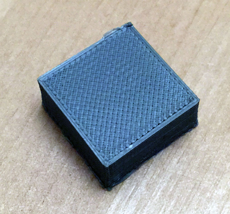

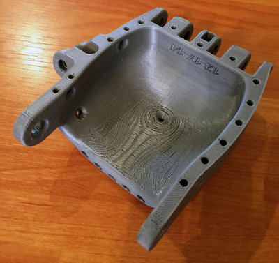

Going well but think my printer might need more calibration, the top layer's of my prints do not look full ?
Any tips on the settings or where to start would be much appreciated.

Under the extrusion tab you could slightly modify the extrusion ratio, for PLA prints it's at .9 for ABS it's at 1.0, depending on which configurable you select. I think those prints look really good, but if you'd like to bump up your extrusion multiplier by 2 or 3 % that might help get what you're looking for.
