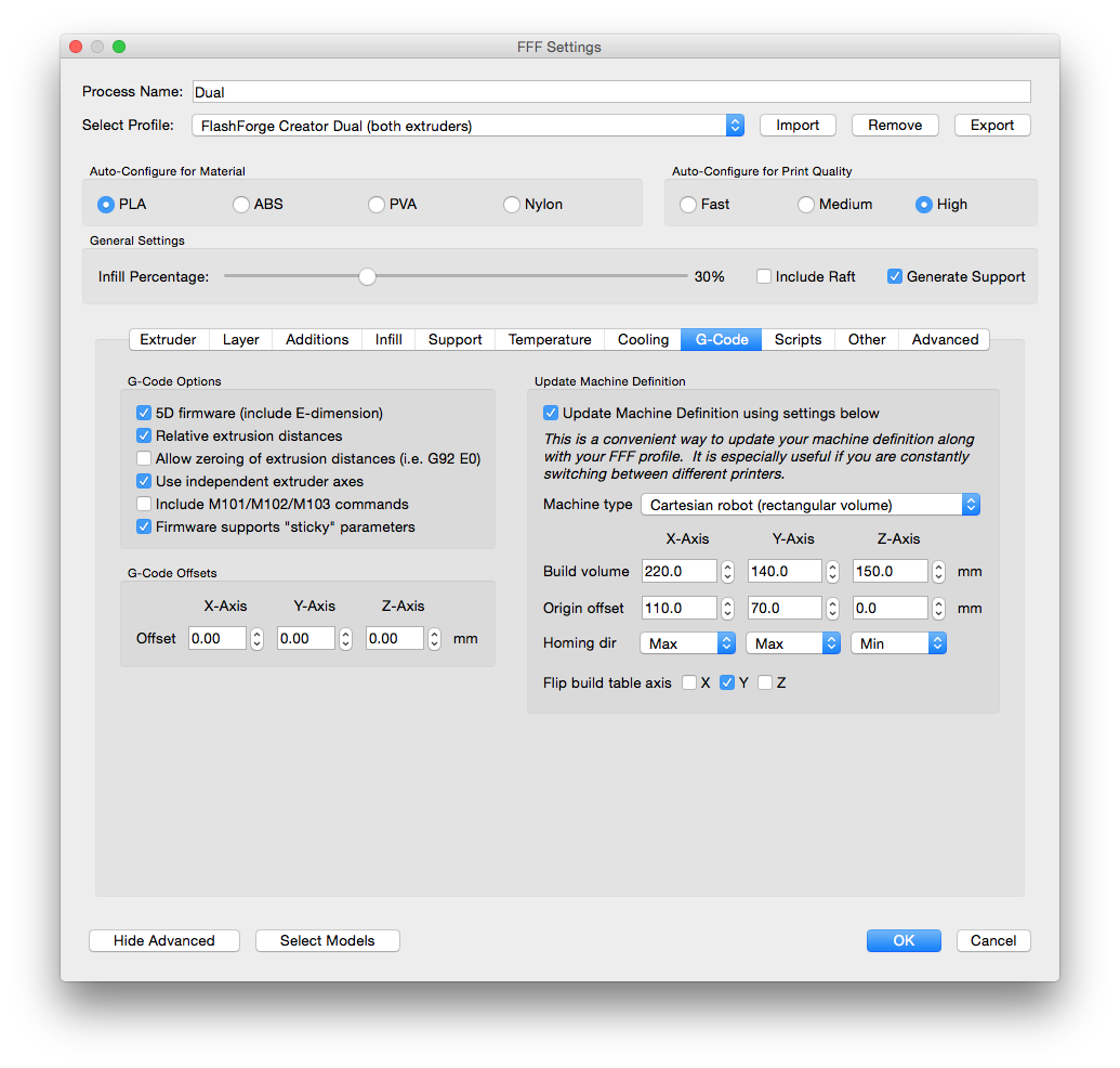

Gcode settings
Gcode settings

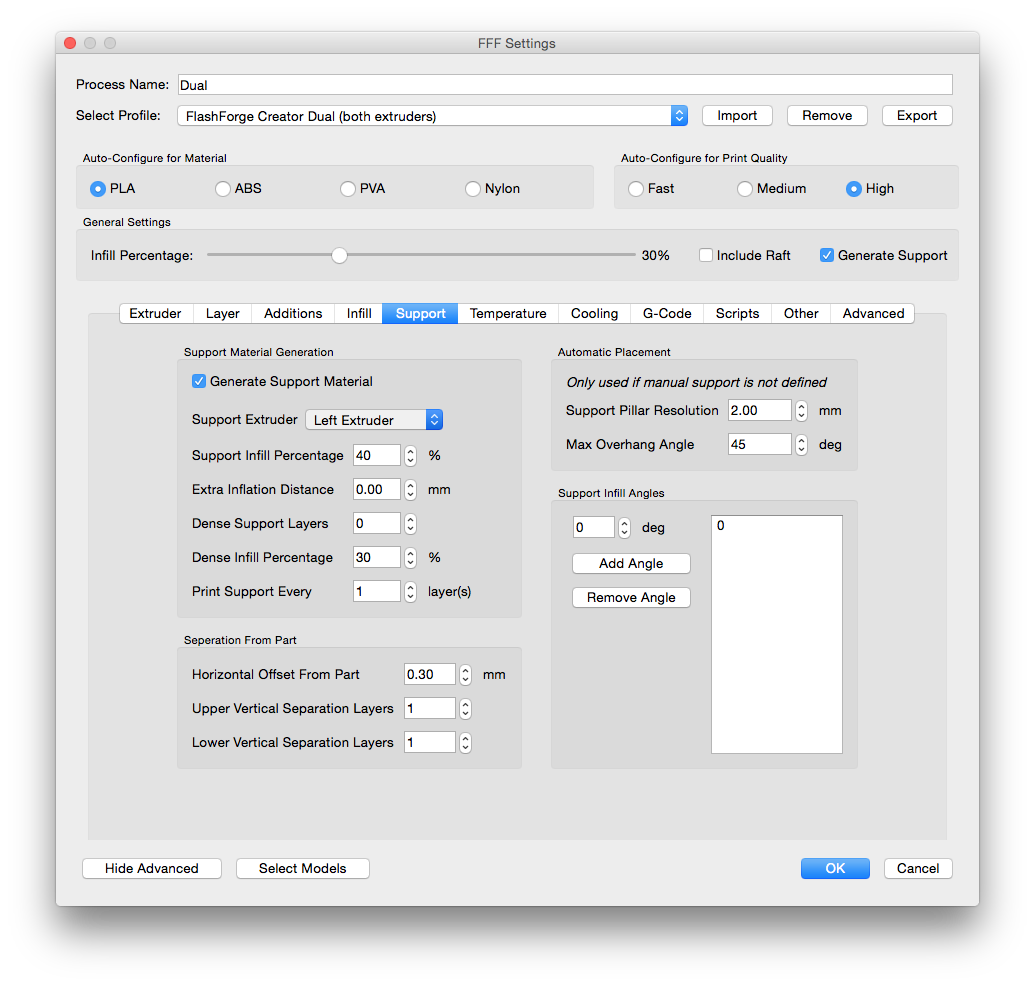

Support settings
Support settings

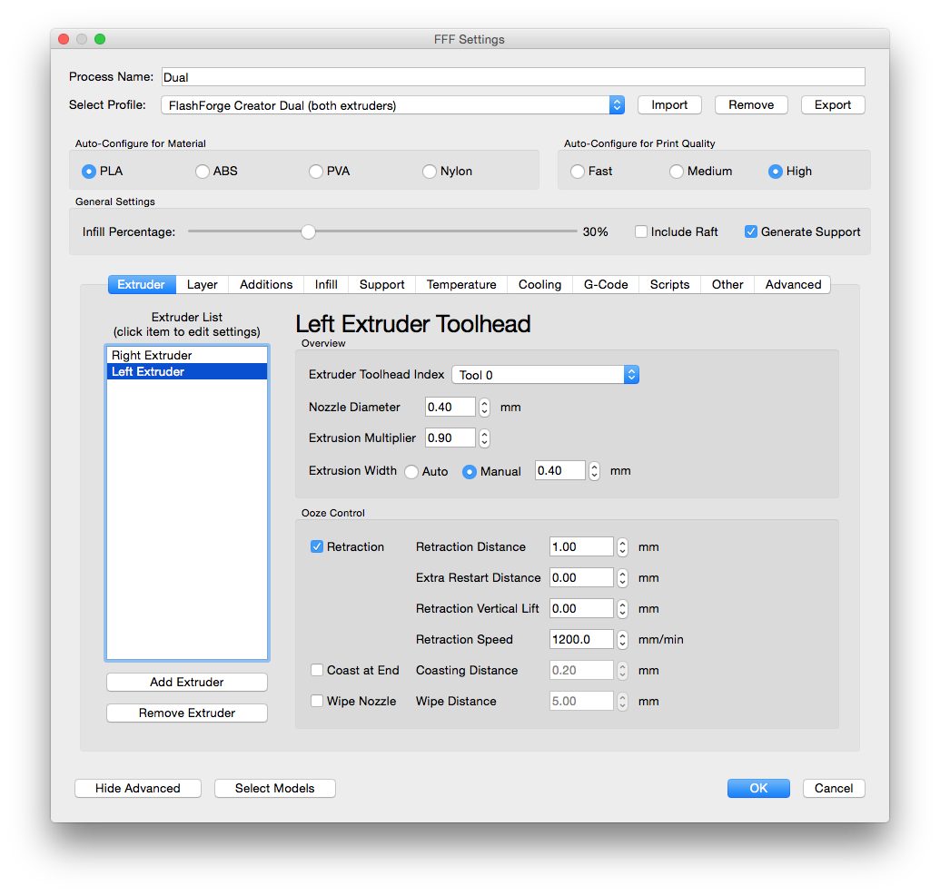

Extruder settings
Extruder settings

try changing the tool head index on the left extruder to tool 1 instead of 0
