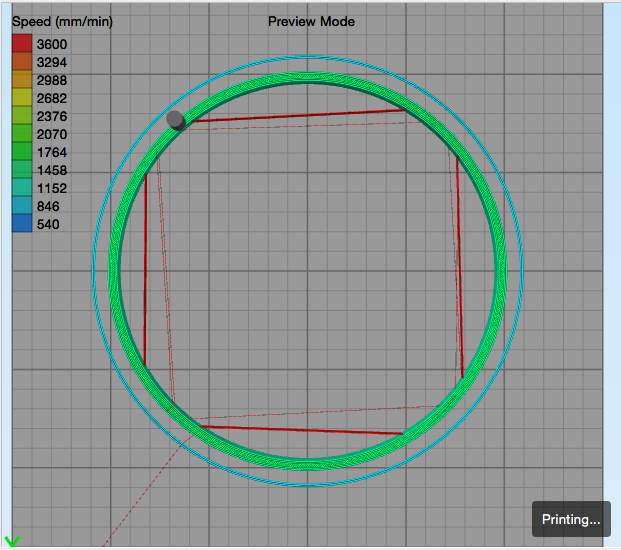

I whipped up a quick cylinder and have sliced it to preview the toolpaths
This is with the default profile in Simplify3D:

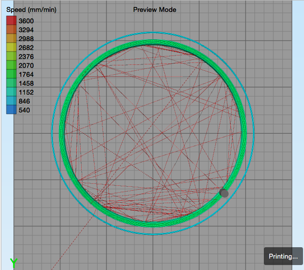

Here is what happens when I change the default "optimize start point" to "random start point"

Your movement (red lines) seem to be really strangely generated!

specify a start point.
it will make a seam however
