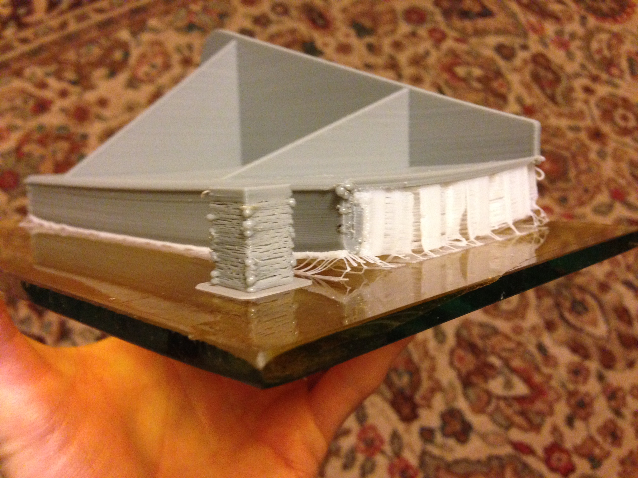

I decided to ignore the temperature bug and print this with S3D instead just to go ahead and try a larger dual extrusion print.
A couple things I learned.
1) Using the external object as a make-shift purge object didn't work. You can from the blobs that sometimes the print order began on the 2nd object even though I used two processes. I had earlier thought multiple processes would solve the issue.
2) I can't set a good tool change retract/begin extrude value because the different timing between layers creates a non-uniform time for the idle nozzle. i.e., on some layers it's mostly support and others it's mostly main filament.
So in summary... still need purge walls. I'm sure you're hard at work at purge walls right now :D :D
