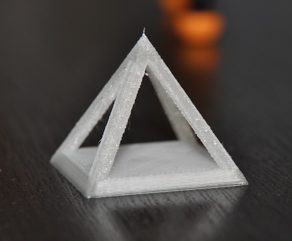

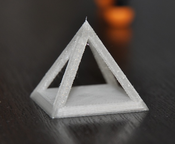

In fact, we print calibration pyramids on our test machines all the time, and we usually get great results using the default settings. The screenshot below is using a stock printer, stock filament, and default settings included with Creator. Literally no tweaks at all, straight out of the box :D
In reality, we can get much better results if we actually tailor the settings for this specific part, but I just wanted to illustrate what the default settings should be capable of doing.

That is one nice pyramid !
But, far from what I can achieve with default M2 settings. I am using Makergear black PLA on a stock printer.

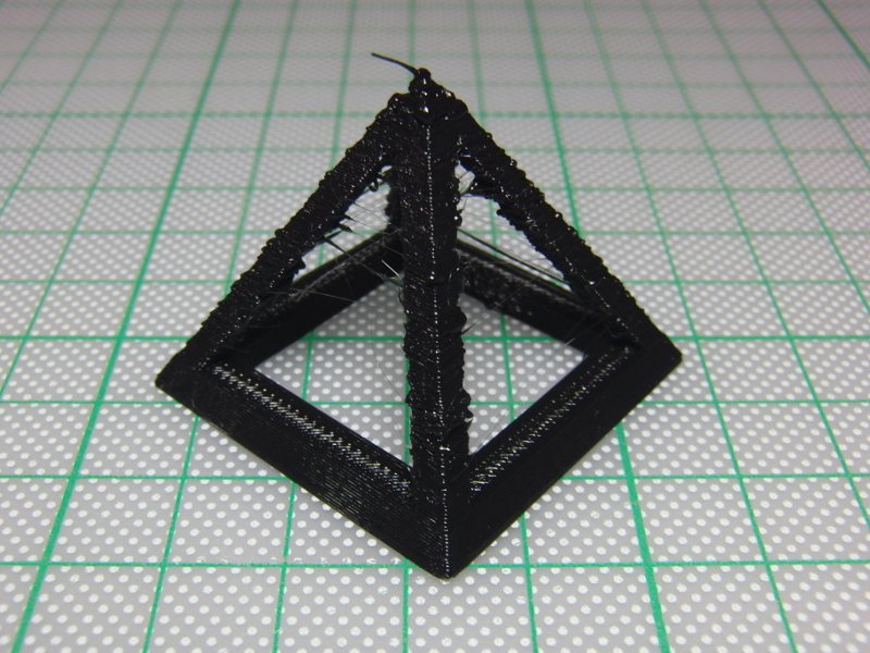

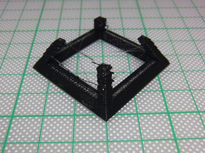

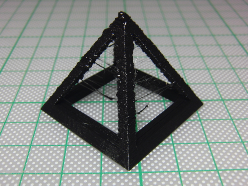

I printed a few pyramids so you can realize how bad this actually comes out with default settings which is quite weird.
I have achieved much better results with different settings, especially at 0.1 mm.
Default PLA settings for high quality, no coast selected
Default PLA settings for high quality, coast at 1mm

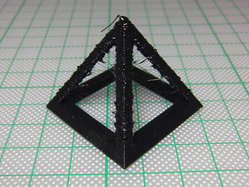

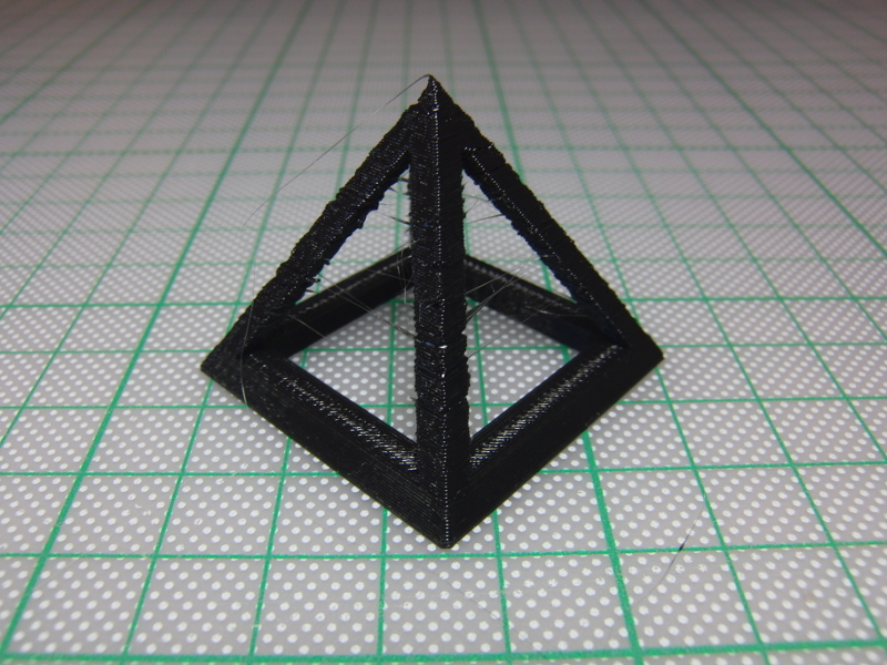

Default PLA settings for medium quality, no coast selected
Default PLA settings for medium quality, coast at 1mm

So theoretically, we printed the exact same part using the exact same settings (our photo was default PLA, Medium quality, no coast). We have also printed plenty of those using the stock MakerGear black PLA and get the same results. So really all that's left at this point is machine or material variation. The excessive stringiness and poor ooze control that you are getting on the 4 small pyramid pillars makes me think this might be related to high temperatures (since those small areas would be affected most by something like that).
Can you verify that your fan was running at 100% during the build? I know some of the M2 fans have a tendency to stick at times. And is there any chance your extruder is running hotter than you are intending? Any chance you have a laser temperature gauge or a spare thermocouple to verify it is actually stabilized at 190 degrees?

The temp is quite high for this PLA and yes it brings up problems. However, I tried the same print at 175. Still problems appear but it is a bit better than the ones on the photos.
The fan I can verify it was at 100% spinning fast. The extruder temp I checked with an IR thermometer and it was spot on.

Another pic of default settings for medium quality using PLA without using coast but using a temp of 175 degrees.
I also noticed that sometimes for a moment the flow out of the nozzle becomes much greater and it messes up everything.
