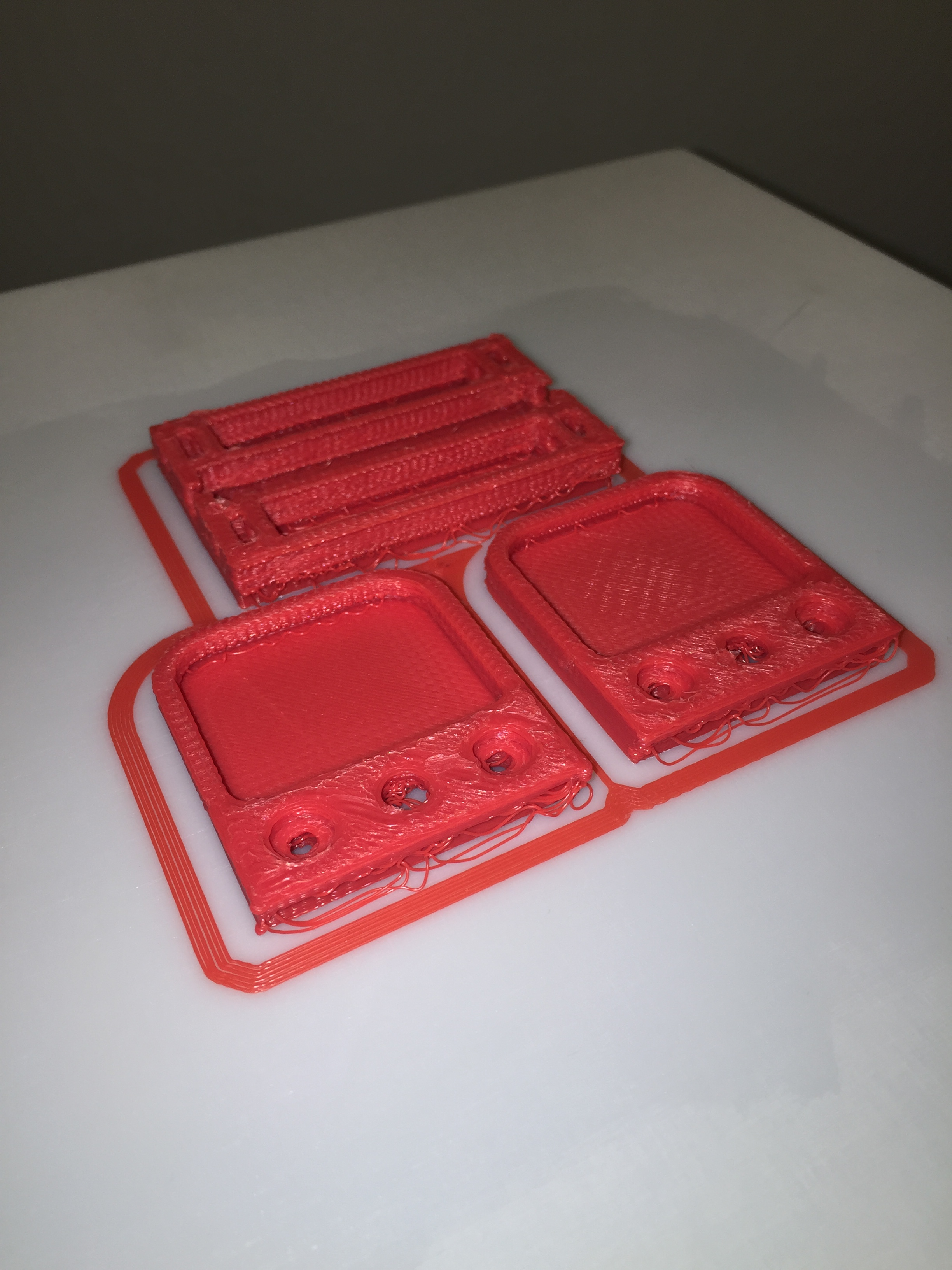

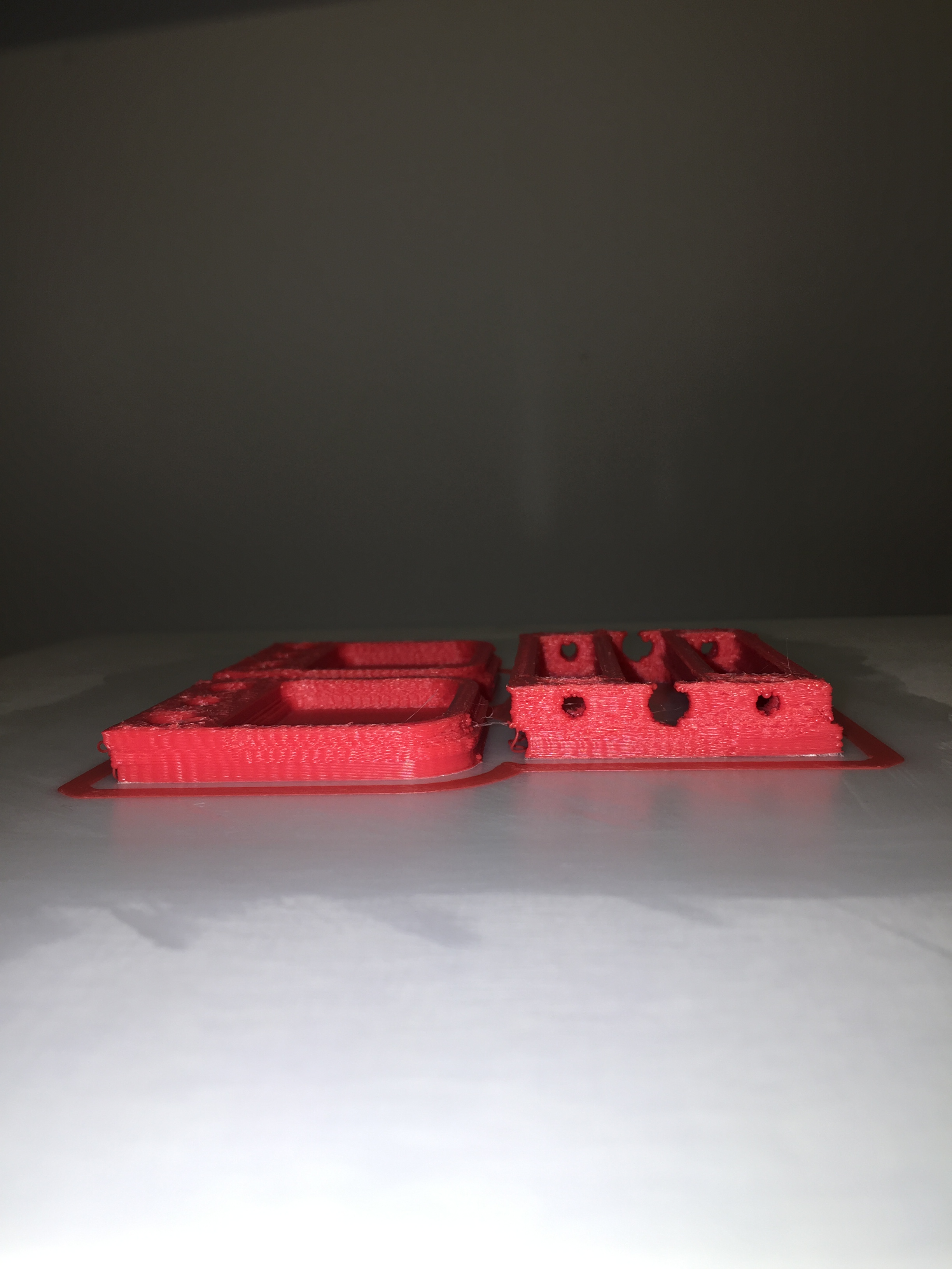

Here are some pics of the test file you uploaded. You'll notice a strange jog in the middle of the part.
**edit below
A couple observations -
rapids seemed to be a little aggressive, I think the jog might be due to a tooth skip or something. There were a couple really short, fast moves in that file (need to drop acceleration?)
The machine struggled with the thin wall fill paths being short - it's not a low inertia print head and those were really fast movements.
Top layer strangely looks really "goopy"
Corners aren't super precise - prime/suck refinements?

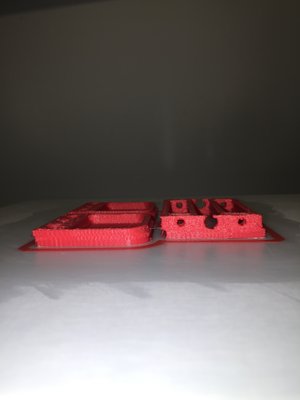

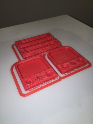

And the other attachments. This file was produced by KISSlicer with the settings from Cubeitmod (but NOT the post processor). The print turned out really nicely other than the silly "pillar" raft.
This pic is too big: https://www.dropbox.com/s/6v25mqtiw5hyd ... 6.jpg?dl=0
