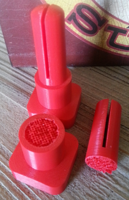

I have this small toy nail that I'd like to print with more layer thickness to make it less likely to break, but there is no foundation being placed between the the upper and lower cylinder.
The walls of the upper cylinder are being placed directly on the infill, which results in a failure point.
I've pasted 2 screenshots of the gcode preview side by side with an arrow pointing at the clear flaw. You can see the 5 perimeters of the upper cylinder are being printed directly on the infill from below, with no foundation under them, so the adhesion is poor at best and the toy breaks easily at this location.

Broken prints:
nail prints
nail prints
