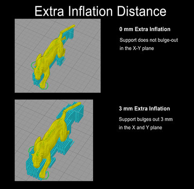

Extra Inflation Distance: This will increase the amount of support generated in the X-Y plane.
