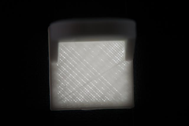

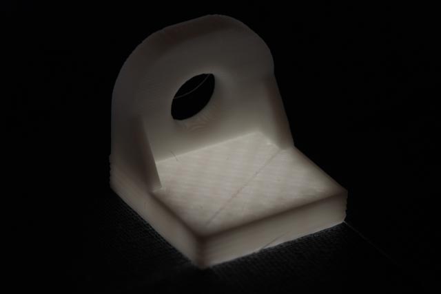

Gaps between filament on top and bottom layers
There are gaps between the filament on the top and bottom layers. The attached images were lit from the bottom to better show the problem. Any suggestions? Thanks.
Replicator 2 w/ Bottleworks HBP
PLA 210 deg, HBP 70 deg

Re: Gaps between filament on top and bottom layers
If the top and bottom layers both have gaps, then you might want to increase the extrusion multiplier by 0.05
