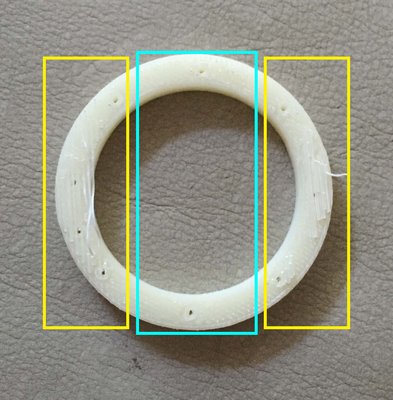

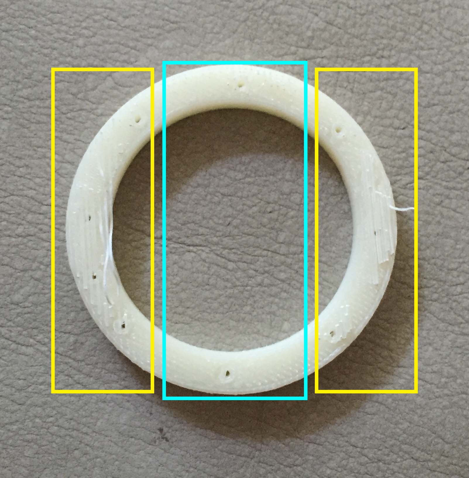

One more thing. In my common test print you can see that in some areas the raft does remove acceptably (shown in the image in cyan) but in other areas it is very strongly adhered to the print layer (yellow). Separation distance is 0.25mm on this example which is printed with a 0.2mm layer height.

Going back to the reported issue. Based on my own printing, and on the above photograph, I have not seen any direct evidence of variance in the adhesion between the top layer of the raft and the first layer of the object apart from where an occasional stray strand gets included in the raft as its printed. What I have had happen...and what I can observe in the photograph...is differences in the way in which the raft layers peel away from the object when peeled away in differing directions. I'll explain how I see the mechanism of peeling.....
When you peel the raft away "with the grain" of the top layer (ie exactly top to bottom in the photo), you're attempting to roll each strand of the top raft layer away, and at any one time the "width" of the tear is a fraction of the diameter of the strand. Now, when peeling "cross grain", you are attempting to tear a width that is the length of the strand attached to the object. As the accumulated "width" of tear between the top layer and the layer underneath is substatially less , then the tendancy is for the second layer to break away before you have put sufficient pull on the top layer! Peeling away at angles between the two tends to give varying results....
Detail in the bottom photo support my theory. Look at the 5 o'clock position on the ring. There's a hole where the raft has been ripped away at approx 45 degrees in the direction bottom left to top right, where you can see short bits of the top layer have separated from the second layer. With a circular object, the tendency is to lever the raft off from the outside all the way round. Top and bottom, the tearing force is mostly "with the grain" of the top layer....and left and right is "against the grain".
So, if I've identified the problem....how do we solve it? And as far as I can see, I don't think there's a definitive answer.....other than peel carefully "with the grain" of the top layar as much as possible, and finish off with a sharp knife.
