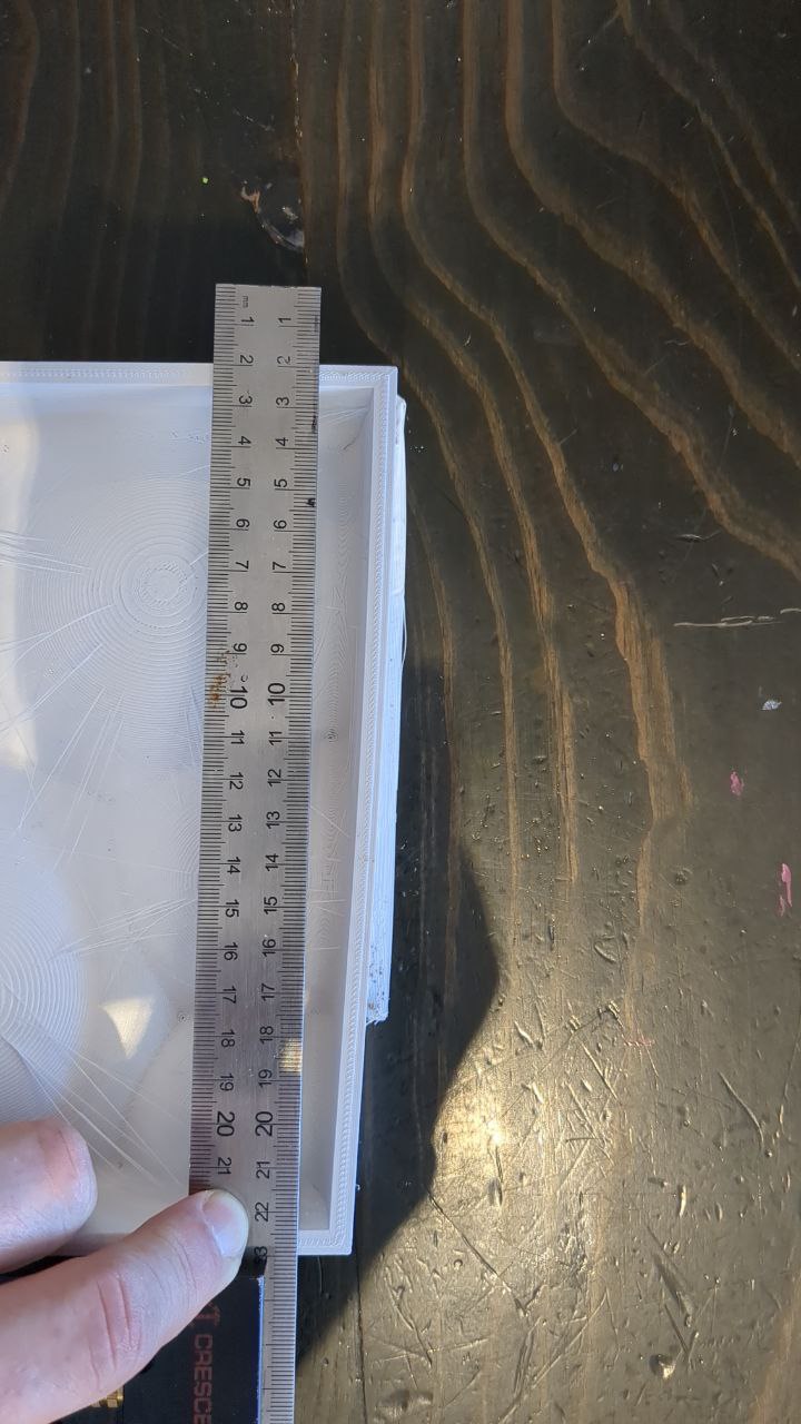

Main machine is a Trinity XL delta (400mm x 600mm h). Its worked well in the past soI started doing some tile prints (ie 200mm square by 25mm h). Did a bed level before I started and notice the be adjustment was like the plate was slope...anyway I let the print proceed as previously it was good enough for draft/test...
The print was actually really skewed/warped (not from heat!...not talking layer shift, I mean skewed like I have never seen before
See Pic 1 attached

Have you checked to make sure all the belts are tight and none of the pulley set screws are loose?
Is the skew the same on every single layer even if you print other shapes?

Yes, it has longs belts and I even put some tension clips on them which worked well on other machines
The skew morphs shape as it goes up
