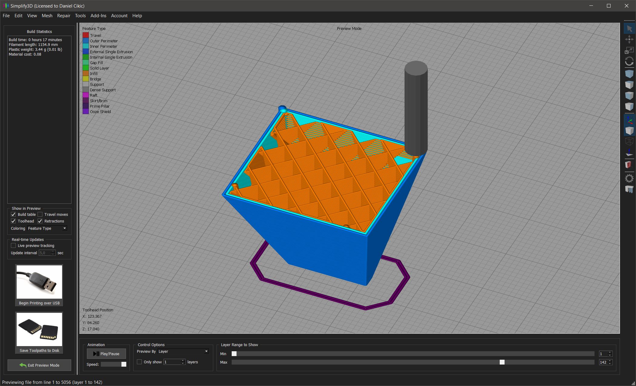

Is there a way to get rid of the small top/bottom layer infill squiggles that run along the perimeter for chamfers, as shown in the attached picture?
I feel like I tried every setting already but, apart from reducing bottom and top layers, nothing seems to work.
I am using v5.1.1. I've attached my profile and the generated gcode as well.

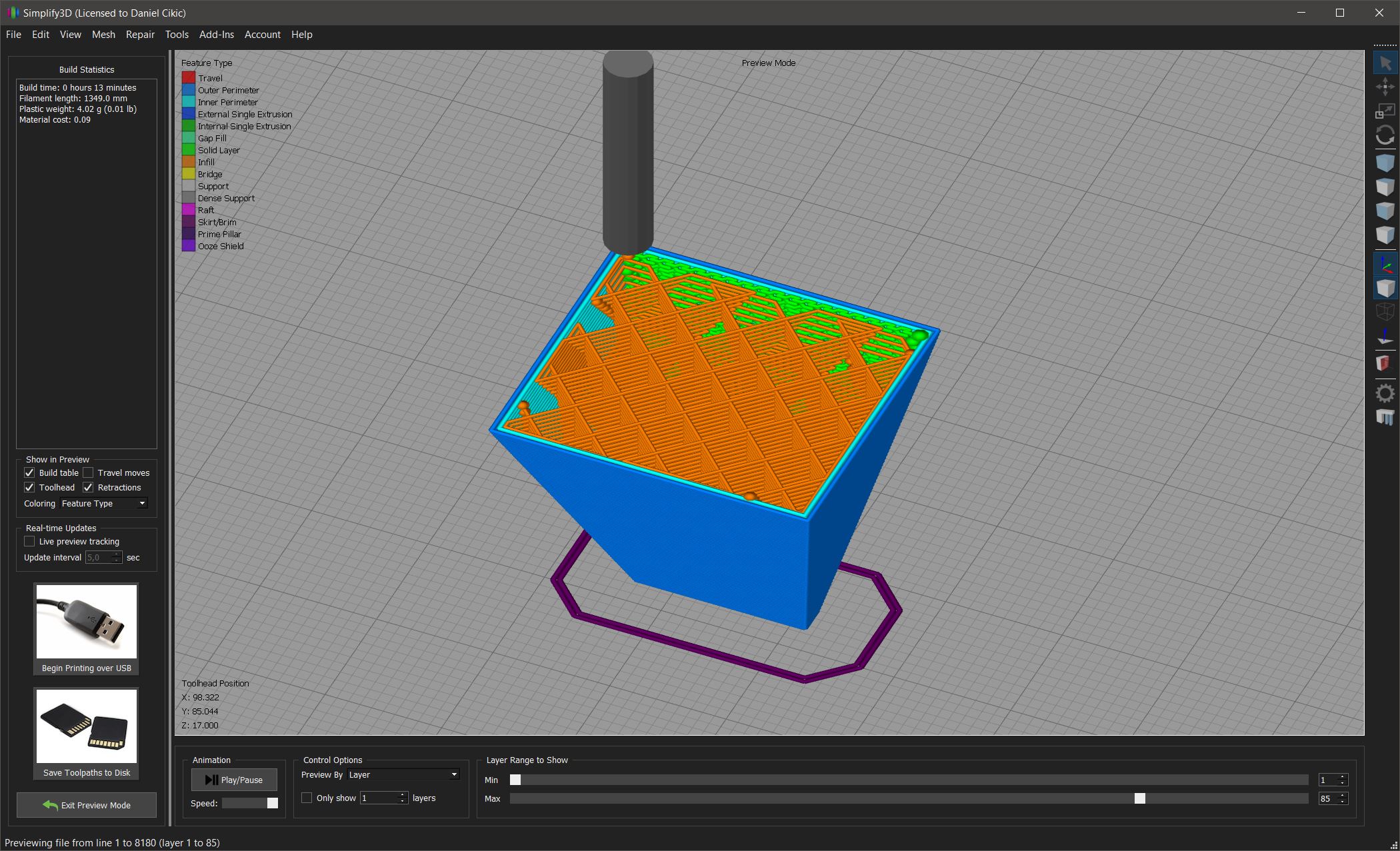

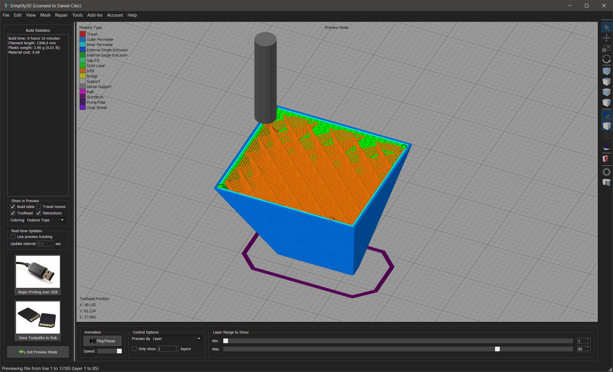

Actually there is a way to adjust this. It's based on the overlap of the perimeters, so you can try to tweak the same settings
you'd tweak for external overhangs: Extrusion Width and Layer Height.
0.20mm layer height, 0.40mm extrusion width:
zigzag support at 30° and 45°
0.20mm layer height, 0.48mm extrusion width (same as auto using a 0.40mm nozzle):
zigzag support at 45°
0.12mm layer height, 0.50mm extrusion width:
no zigzag support up to 45°
