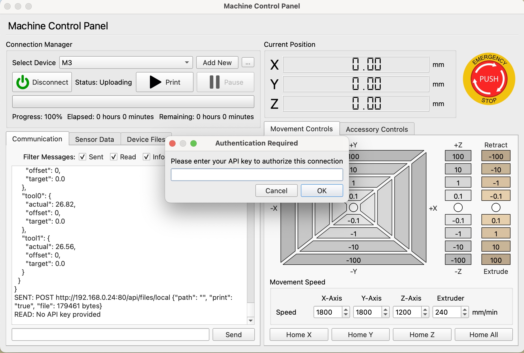

I joined the end of the log, that shows clearly the missing API.
I attached a screen copy showing that

Connection successful!
File upload started...
SENT: GET http://192.168.0.24:80/api/version
READ: No API key provided
READ: {
"api": "0.1",
"server": "1.3.6"
SENT: GET http://192.168.0.24:80/api/printer
READ: {
"sd": {
"ready": false
"state": {
"flags": {
"closedOrError": false,
"error": false,
"operational": true,
"paused": false,
"printing": false,
"ready": true,
"sdReady": false
"text": "Operational"
"temperature": {
"bed": {
"actual": 26.82,
"offset": 0,
"target": 0.0
"tool0": {
"actual": 26.82,
"offset": 0,
"target": 0.0
"tool1": {
"actual": 26.56,
"offset": 0,
"target": 0.0
SENT: POST http://192.168.0.24:80/api/files/local {"path": "", "print": "true", "file": 179461 bytes}

OctoPrint keeps responding and saying "No API key provided". Did you provide the correct API key when the popup was displayed in S3D?
hdlbq
Posts: 26
Joined: Thu Aug 29, 2019 5:53 pm
Re: Machine control panel issues
Yes.
And I don't provide any API key when I connect without lauching any printing.
