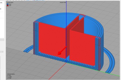

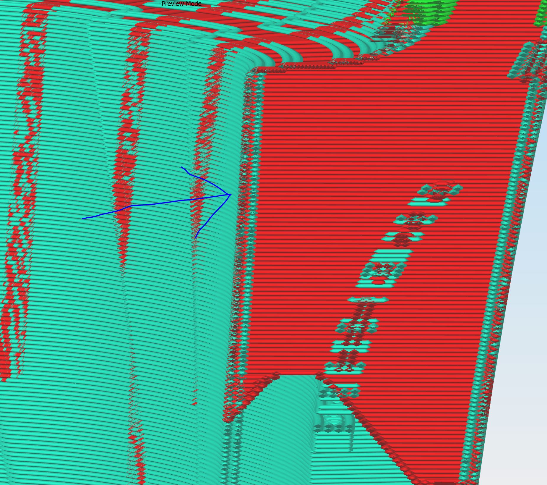

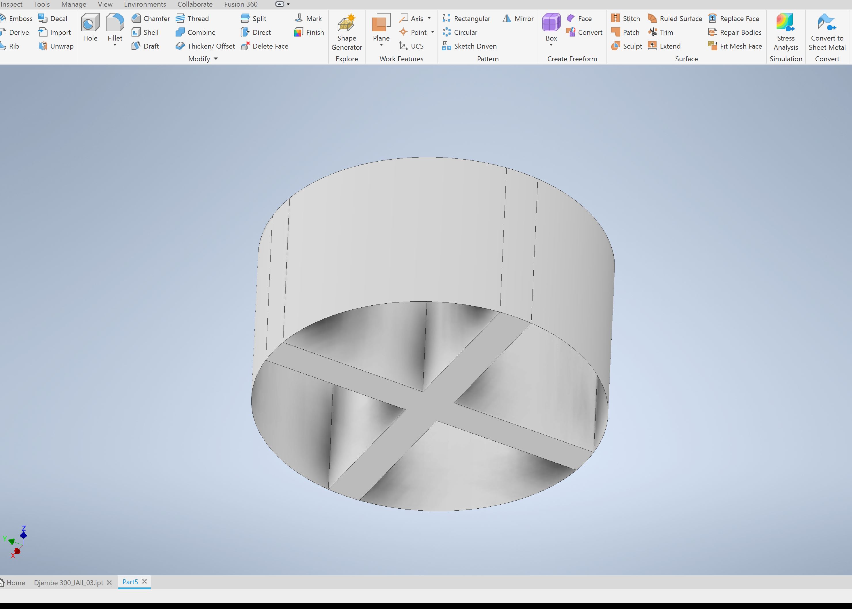

Im wondering what will happen with this pic...will there be a collision?
If so, how can you get multi parts to work with each other?
These are reinforcement ribs so they need to be connected
Where can I find the detailed information about this?
Cheers

Thanks for your reply but there isnt much to it and the picture I thought would describe it
2 components:
1 is a shell,
2nd is internal ribbing contained wholly within the shell
They need to print together using different process and manage the overlap
Here is a simple example I hope helps;
Could you confirm behaviour as it doesnt look right?
Source object which is split into 2 components
The blue is an outer shell with its unique process
The red is a proxy for reinforcement ribs using a different process

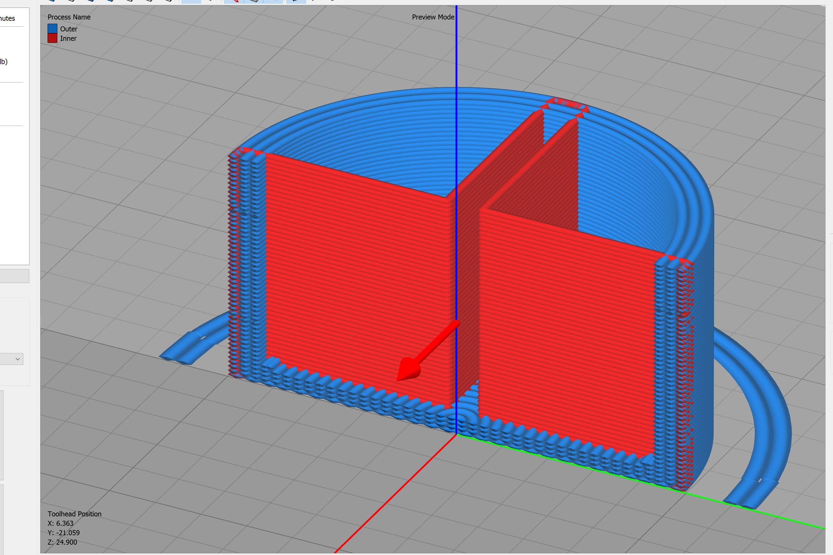

Looks like a collisiion? @Js3d-Jason.? The outer perim is not taking the inner perim of the shell object into account
Overlap.factory
(20.18 KiB) Downloaded 294 times

Those 2 STL files are completely overlapping with one another, so I don't think you'll be able to achieve what you want use those 3D models alone.
If you want to add reinforcement ribs to the outer cylinder, you would typically just union those parts within your CAD package and then export the combined shape.

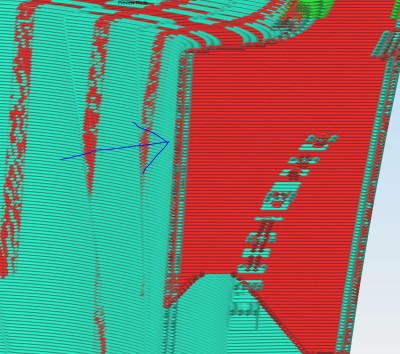

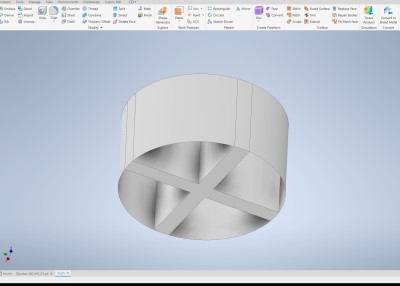

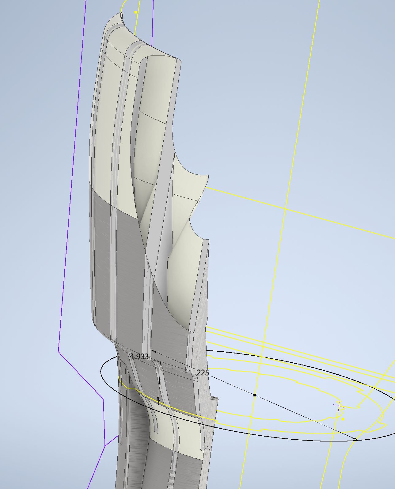

Thats how I first started...but I was looking at other options ie markforge where their slicer is used like this and combines the objects.

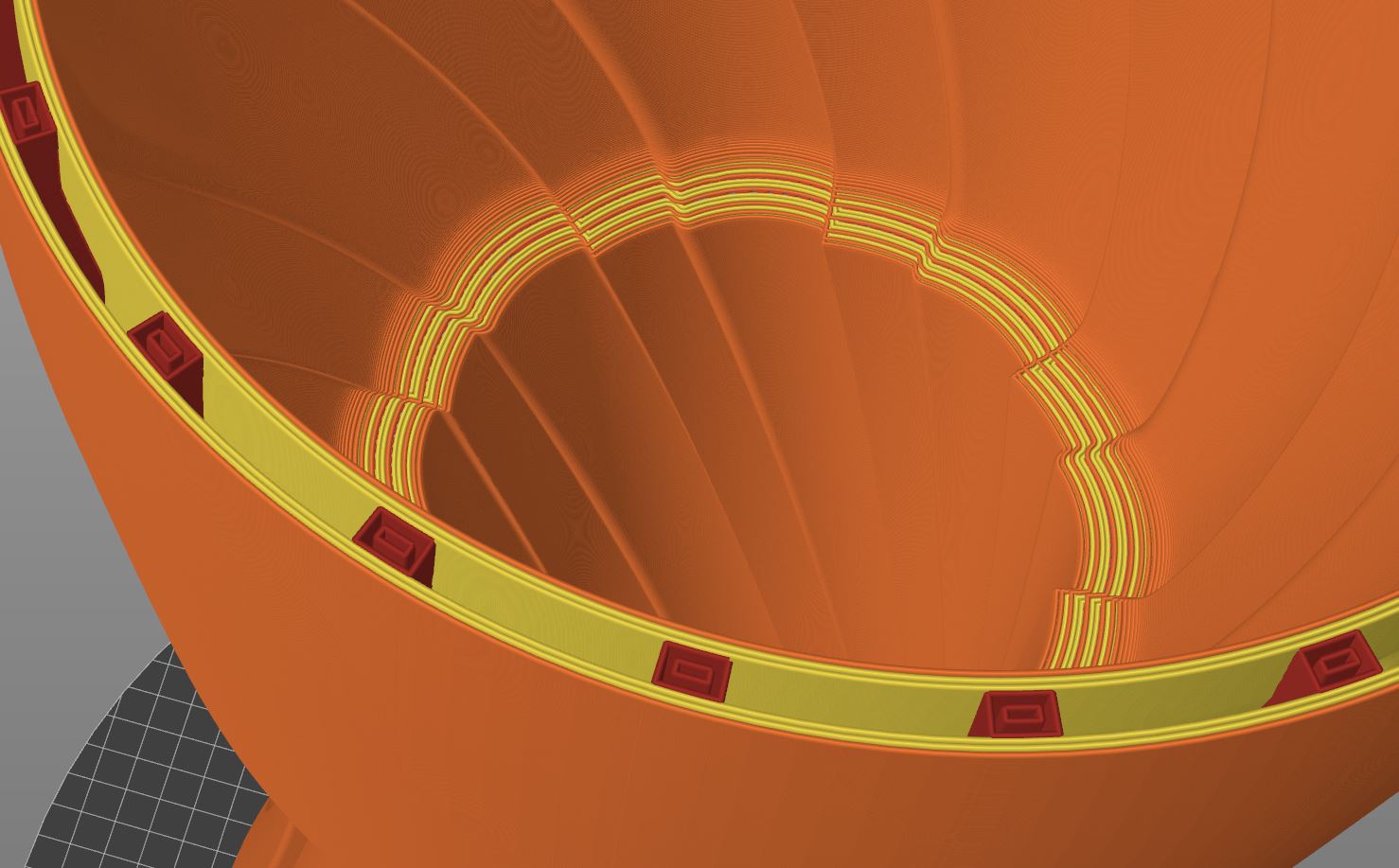

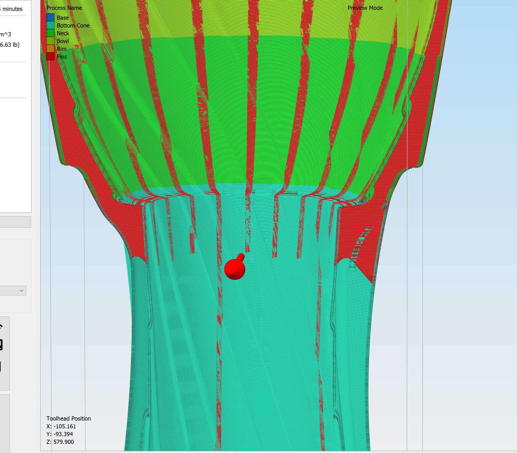

Here is an example where I combined the geometries and left them open,, no matter what setting I use, it does not resolve the issue? I dont want it to heal and close non manifold portions, I simply want it to print the presented skins. This is common practice in industrial modelling...can it be this hard :-( ?

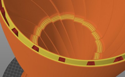

In prusa you just add composite components as 'sub part' to consistently assemble overlaps...like this

It does print the skins, but those skins intersect and cross through one another. I would recommend doing a union operation in your CAD package so that you have actual solids for printing. That's is usually more reliable than having open non-closed skins.

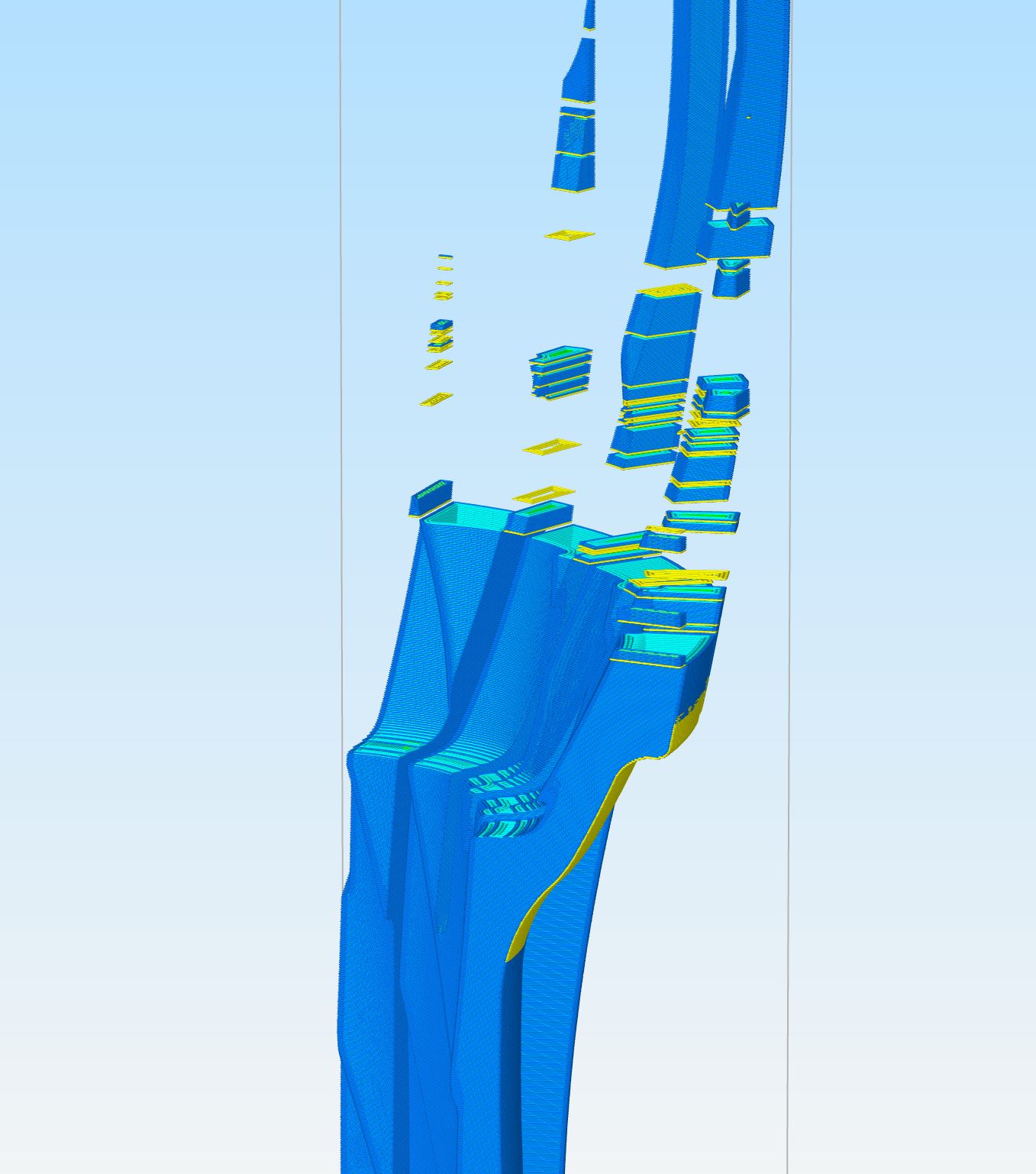

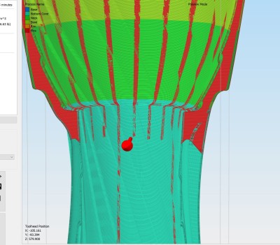

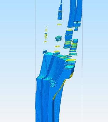

S3D-Jason wrote: ↑Tue Aug 01, 2023 9:42 am It does print the skins, but those skins intersect and cross through one another. I would recommend doing a union operation in your CAD package so that you have actual solids for printing. That's is usually more reliable than having open non-closed skins.
Something is getting lost in the translation maybe
The image above is from prusa which is managing the overlaps correctly and Im now using that instead
The previous post to that actually confuses s3d and none of the settings re: non manifold solve the issue even when I import the model as one union as then I cant apply diff settings to each component...anyway no time for this :(
Its ok as I now have a solution with Prusa slicer and am working now and able to complete jobs.
I have not been given a working solution from S3d and as far as I can see, its not capable of solving intersecting parts.
