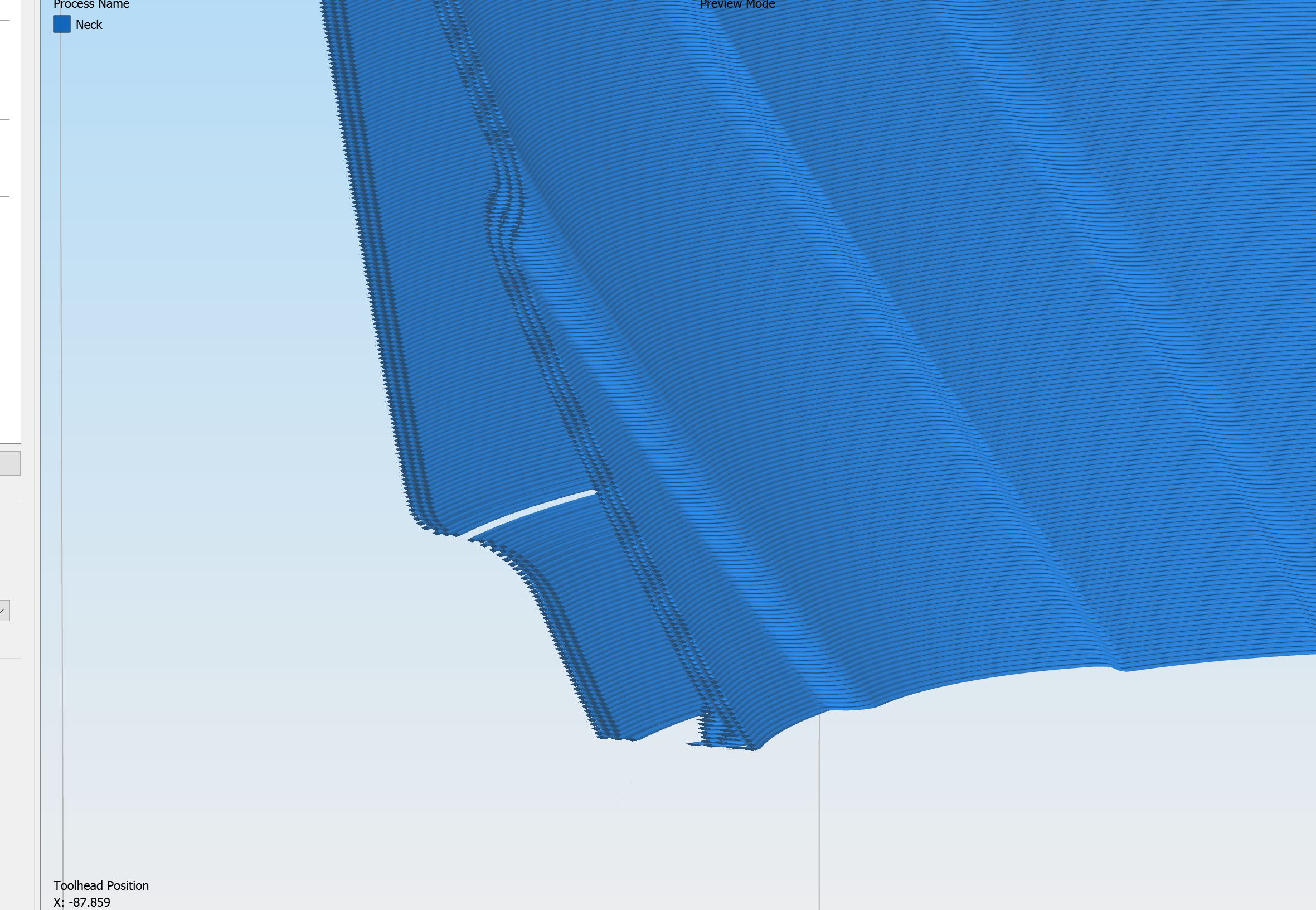

Is there a way to take an assigned zone eg 350-450mm high seciton of a model and have that section drop to the table so that it can be test printed by itself. I have large models and need to test just particular sections
And are transparent areas ie gaps an issue to be concerned about?
