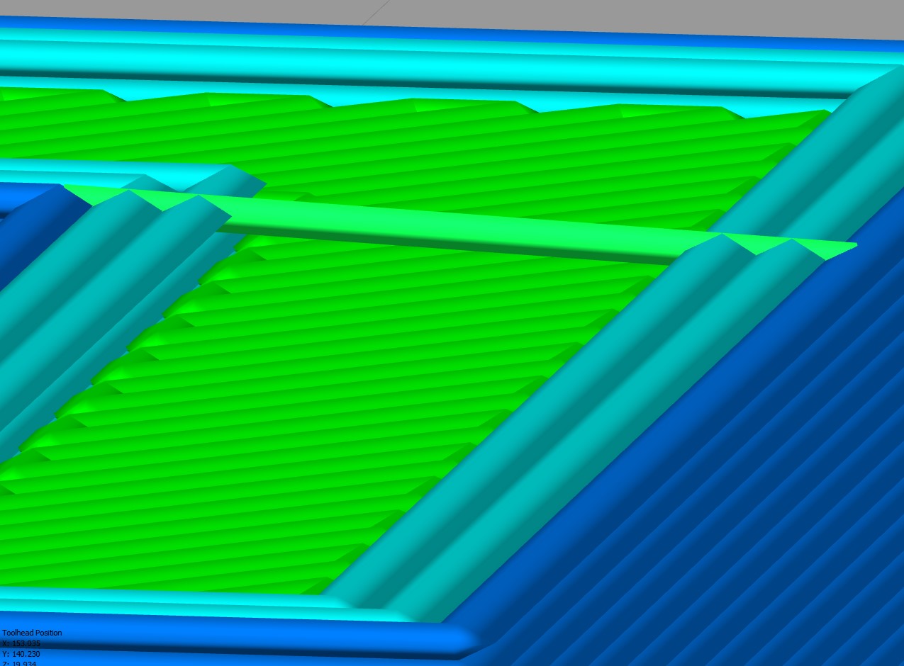

I'm using verison 5.1.2 and have the following problem:
If I check the ironing feature then its printing the top outlines afterwards it's doing the ironing process and then the top solid is printed.
But I think it should first print the top solid and then doing the ironing.
Maybe I do something wrong, but i can't find any option to correct this issue.
regards
Roman

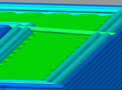

Sure, here is the factory file.
If I play the preview line by line then I first see the the outlines, then the ironing and last solid.
It's also printing in this order.

It's really weird. I found an old profile where the problem does not exist. I changed now value by value and found something :shock:
At speed config if you set the solid infill speed to 50% then the problem is existent. If you change it to 49% or 51% the problem is gone :shock:
