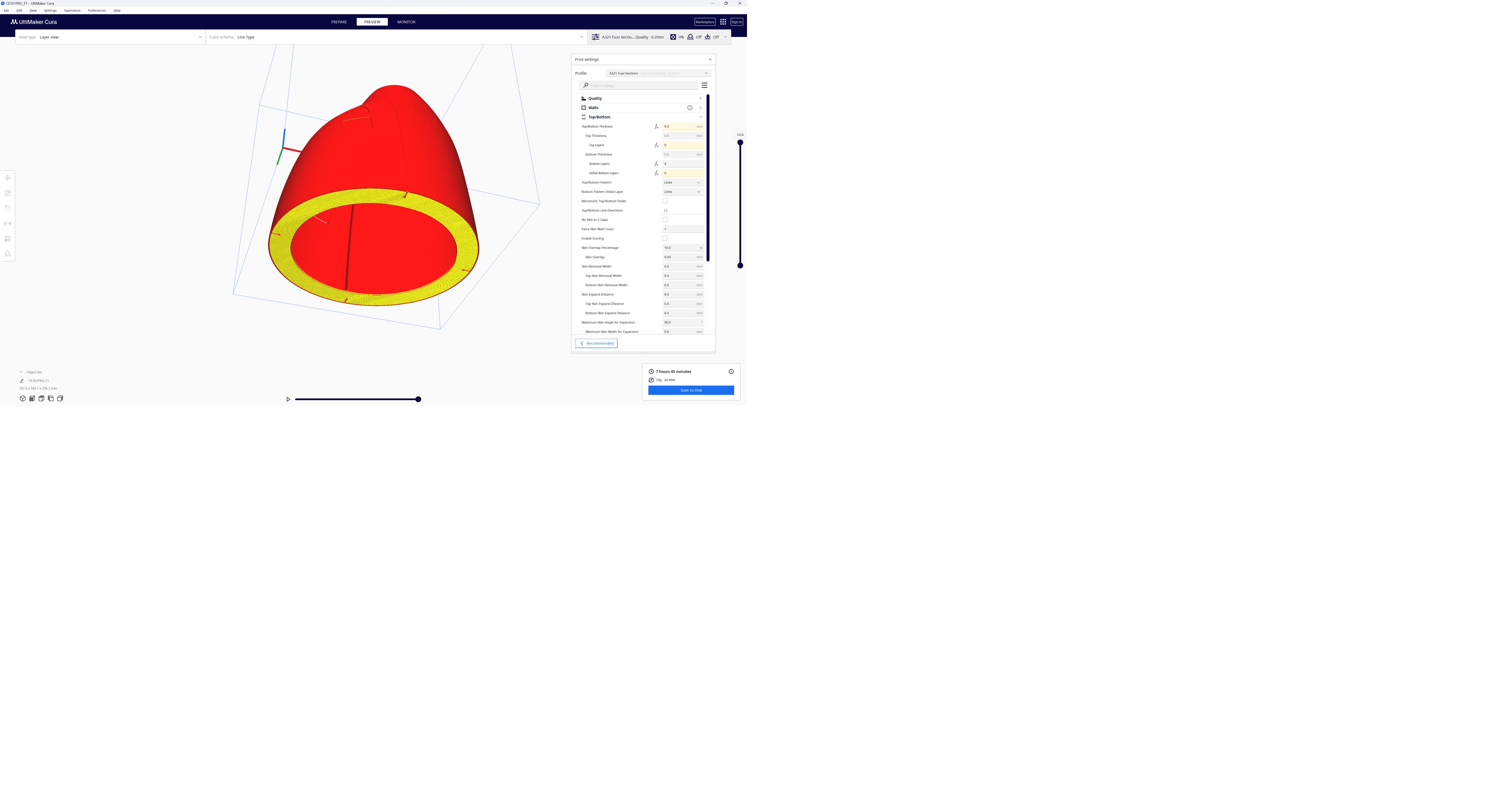

I'm after some help with a strange issue. I've just move to Simplify 3D after having issues with Cura and 3D printed planes. I'm trying to print a A321 Jet liner and brought the files from Cults 3D. When I open the files in Cura and slice them I get a hole in the bottom. When I slice the part in Simplify 3D I get a solid bottom. Does any one know how to fix this. They both have the same number of bottom layer (4). I have attached images of the problem and the file I'm trying to print.

Simplify 3D sliced
Simplify 3D sliced
Cura sliced
Cura sliced

Re: Part Won't Slice Correctly
Go to Edit Process Settings > Advanced tab > and make sure the "Slicing Region Repair Mode" is set to positive or alternating fill (but NOT "merge all boundaries").
That didn't work on the version I'm using.
What version are you using?
It slices fine for me in 5.1.2. What version of S3D are you running?
TheBum wrote: It slices fine for me in 5.1.2. What version of S3D are you running?
I'm using version 5.1.2.
I just won't to confirm that you get a hole in the bottom. It does slice ok but I don't get the hole in the bottom.
I don't see a hole when I view the file in macOS Preview. Normally when something like this happens, there's an extra mesh in the file and you can get rid of it by using the Separate Connected Surfaces option in the Mesh menu and deleting the meshes you don't want. However, that doesn't work with this model, so there's something else wrong with the file. I'd suggest loading it into MeshMixer and doing a repair operation.
