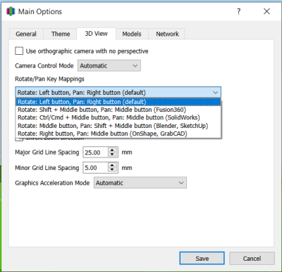

Re: Pan hotkey customization on laptop
Tools -> Options -> 3D View

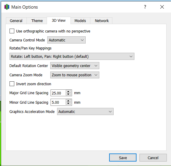

Thanks for replying, but that's the section I was talking about where the only options available are control schemes from other programs and doesn't allow changing the hotkeys individually. All it would allow me to do was make another control inaccessible instead.

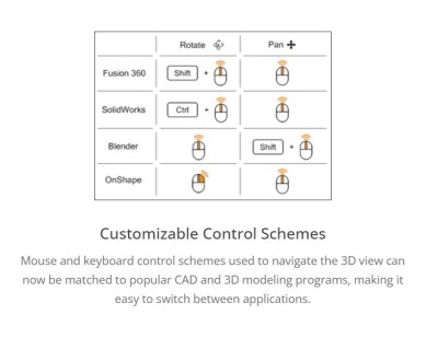

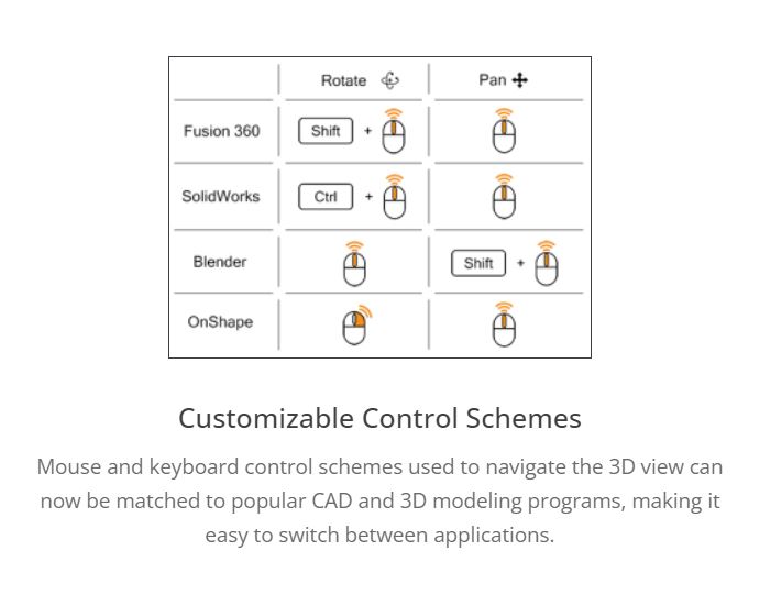

Just for clarification:
This is all that's left in v5 (from their 5.0 feature list):

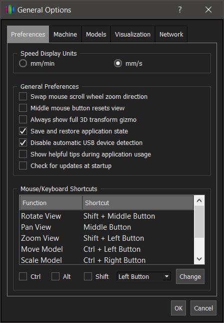

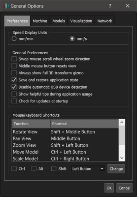

compared to v4, which did allow for complete custom mappings:

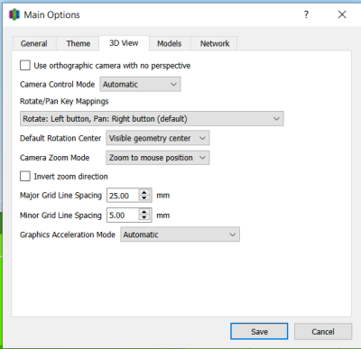

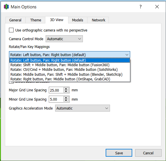

Here's a screenshot of the 3D View menu:
And the pathetic options offered therein:

SoLongSidekick wrote: - Completely custom hotkeys: NO
V5 actually added full application-wide keyboard shortcut customization. Go to Tools > Keyboard Shortcuts and you can change the shortcuts for almost any action in the software. V4 didn't have that ability at all.

And finally, I'll add a few more thoughts on the original questions raised in this post. With V5 we changed the 3D view options to make it easier for customers to quickly match their favorite CAD software. We had seen that this was the main reason customers were using that setting in the first place - they were already used to a specific CAD package and they wanted the 3D view in S3D to work the same way. Now that's done with one simple click instead of having to change all of the options separately which we had seen was confusing for most customers. We added 5 different control schemes which should cover the vast majority of users, but if there's additional schemes you want to use, that would be a great thing to propose on the Feature Request sub-forum so we can see how many other users want the same change.
