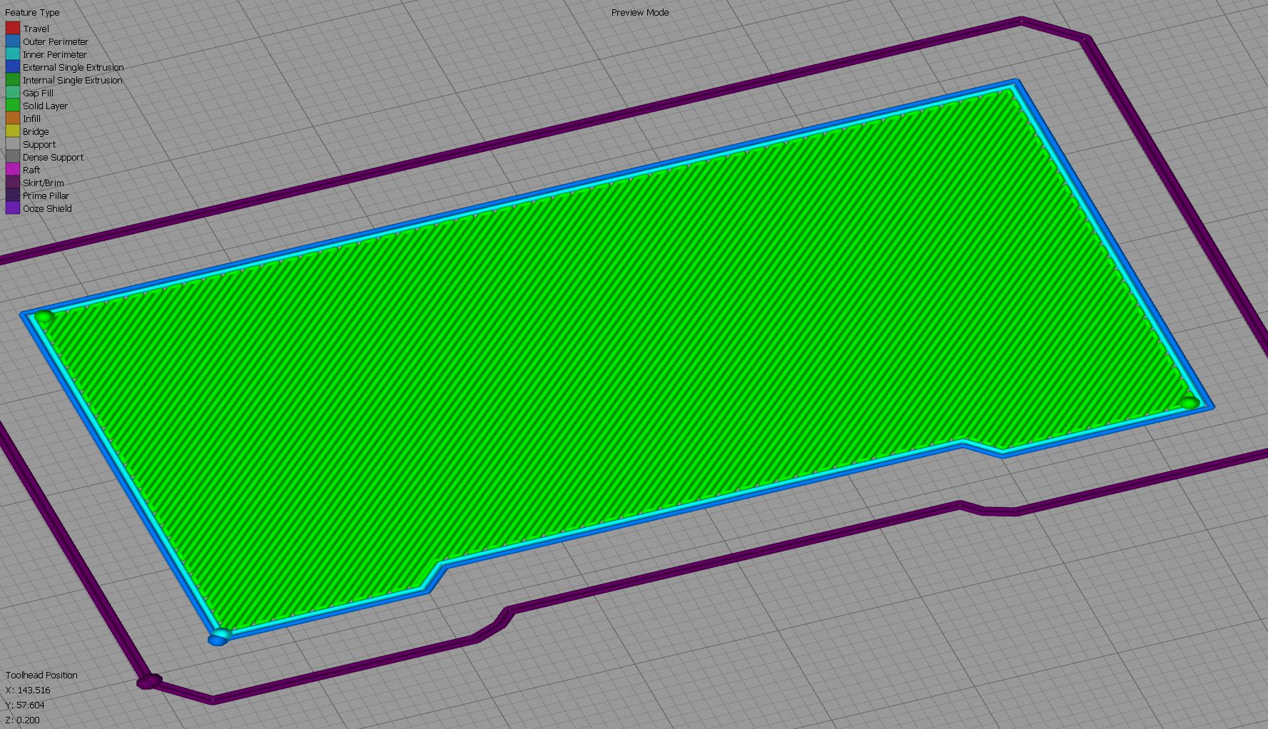

Why would S3D do this, area indicated by yellow arrows, on the first layer. It breaks the first layer into two sections which makes the surface of the print look bad. Remaining layers print ok or fill in to the perimeters without the break.
Model has been checked and is error free.
Surface is flat and 100% on the bed.
Tried three different printer profiles and materials and get the same thing.
Tried a variety of settings changes and it doesn't change.

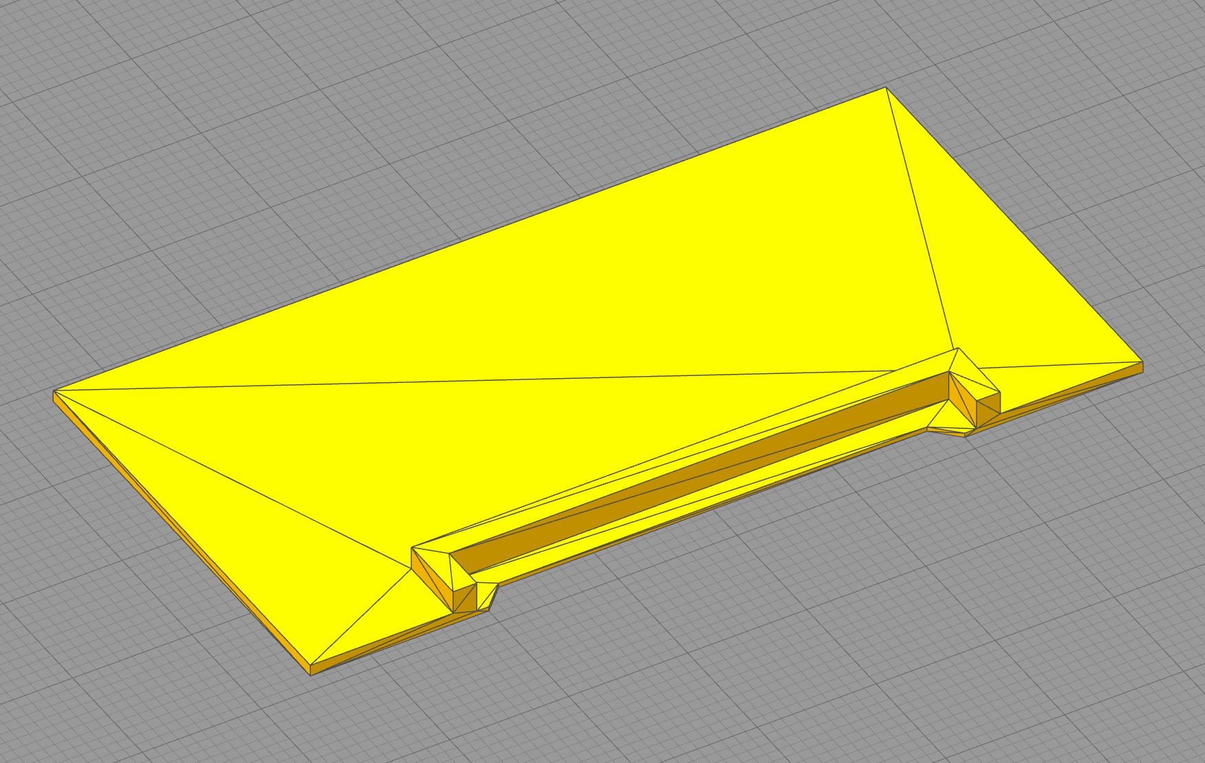

Then at least share an image of the section in question. It's obvious there's some thin wall feature or a
height change in topology coming, because what you're showing in your first post highly suggests this...

The model is as it looks. It is 5mm thick and the shape is what you see, it does not change as layers increase. Just a flat model at that end. No change in geometry.
I tried a number of settings changes including layer height, number of top/bottom layers, number of walls, extrusion width, speeds etc. Nothing seemed to make any difference.
Tried my profiles for three different printers and got the same results.
Ended up printing it using a different slicer and it printed fine and no issues with the resulting print.
No idea why it did that. I did not think to try it in version 4 though, so I just checked it and it slices fine. No issue.
So this issue is limited to V5. I am not surprised as this is not the first slicing oddity I have seen in V5.
May be one of those things we never find an answer to!
