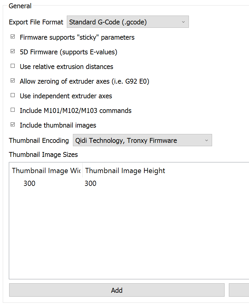

Did you already try using the Qidi thumbnail option in V5 on the Output tab of your process settings? That works with several of the Qidi printers we have in our office.

Yes, that is enabled. I did not see that option before. But it is enabled by default.

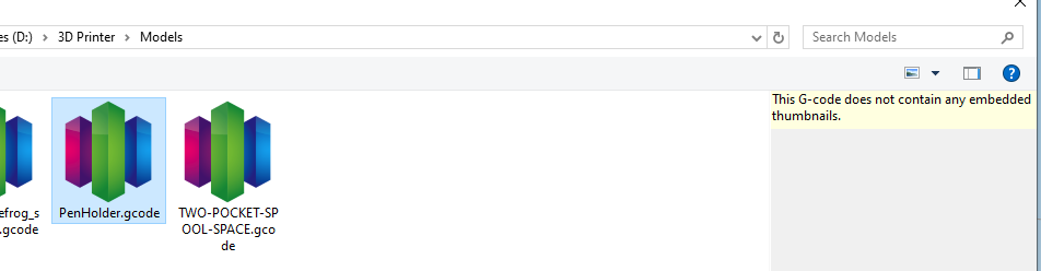

When viewing the file in Windows, I get this.
I changed it to OctoPrint, Klipper.... and now it works in Windows, but not on Printer Screen.
The encoding is not correct for the latest QiDi firmware?
