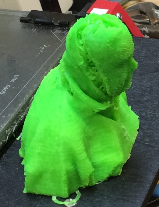

Any ideas why this happens? I'm printed this in ABS at 230 degrees C with a bed temperature of 110 degrees C sliced at .1mm.

My guess is one of or a combination of two things:
1) too small layer height relative to nozzle size.
2) too low resolution on your extruder stepper driver axis.

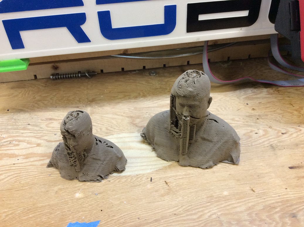

Here is the model printed in bronzefil. Different material, same results.
DarthRevan
Re: Why does this happen?
You should be fine with those settings. Perhaps your machine needs to be recalibrated. As bronzefill is one of the pricier materials I'd try printing some calibration prints in PLA. You definitely want the settings perfect when using <= .1mm layer height, as the margin for errors is much more noticeable the more detail you aim to have.
Would you suggest .2mm layers?
