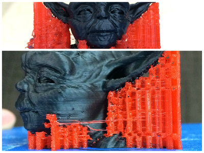

I haven't completely dialed in my dual extrusion print settings yet but I did this in two colors to really show how the supports do contour to the models surface at the top of the support structure and at the bottom.
I can see how you'd think the supports need support but in fact they do not. see attached photos.

Actually they only appear to if you have enough SMALL supports and a shallow enough base surface for them to rest on. Your Yoda example has much flatter area than a lot of my busts' chest and necks that the ear, chin and other supports rest on. The resulting path layers on the bottoms of the supports are only contoured if the support towers that make them up are small enough to "antialias" that curve.
To test this theory try your yoda again with supports that are twice the mm size and run prepare to print again. You will see what I mean. Or put your octopus model on top of a very steep pyramid model and check that out.

by DarthRevan
mitchfx wrote:Actually they only appear to if you have enough SMALL supports and a shallow enough base surface for them to rest on. Your Yoda example has much flatter area than a lot of my busts' chest and necks that the ear, chin and other supports rest on. The resulting path layers on the bottoms of the supports are only contoured if the support towers that make them up are small enough to "antialias" that curve.
If you look closely at the images I posted from the software, you can see on the shoulders there are overhangs like you're describing. But the overhang results in the printed material dropping to just barely rest upon the model surface. Creating a contouring effect that is also barely attached and easy to remove.
