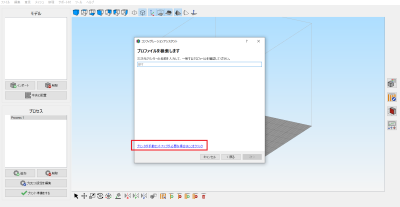

When I create a custom printer that does not exist in the list from Help -> Custom Configuration, even if I change it from the default 200mm, it is still 200mm when it is actually created. Why is this?

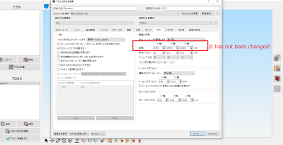

I couldn't get the screen recording to work, so I'm sending you a screenshot.
I am trying to change the Plate size from 200mm to 500mm.
However, it hasn't been changed.
Posts: 1427
Re: Custom profile changes are not saved
Odd... I don't think we've seen anyone else have this issue. If you click "Edit Process Settings" and try to change other settings like layer height or extrusion multiplier, so those changes save successfully?

I was "Edit Process Settings" and try to change other settings like layer height or extrusion multiplier, but it is not changed.
Changing these items will not be marked with an *. it will not be saved.
