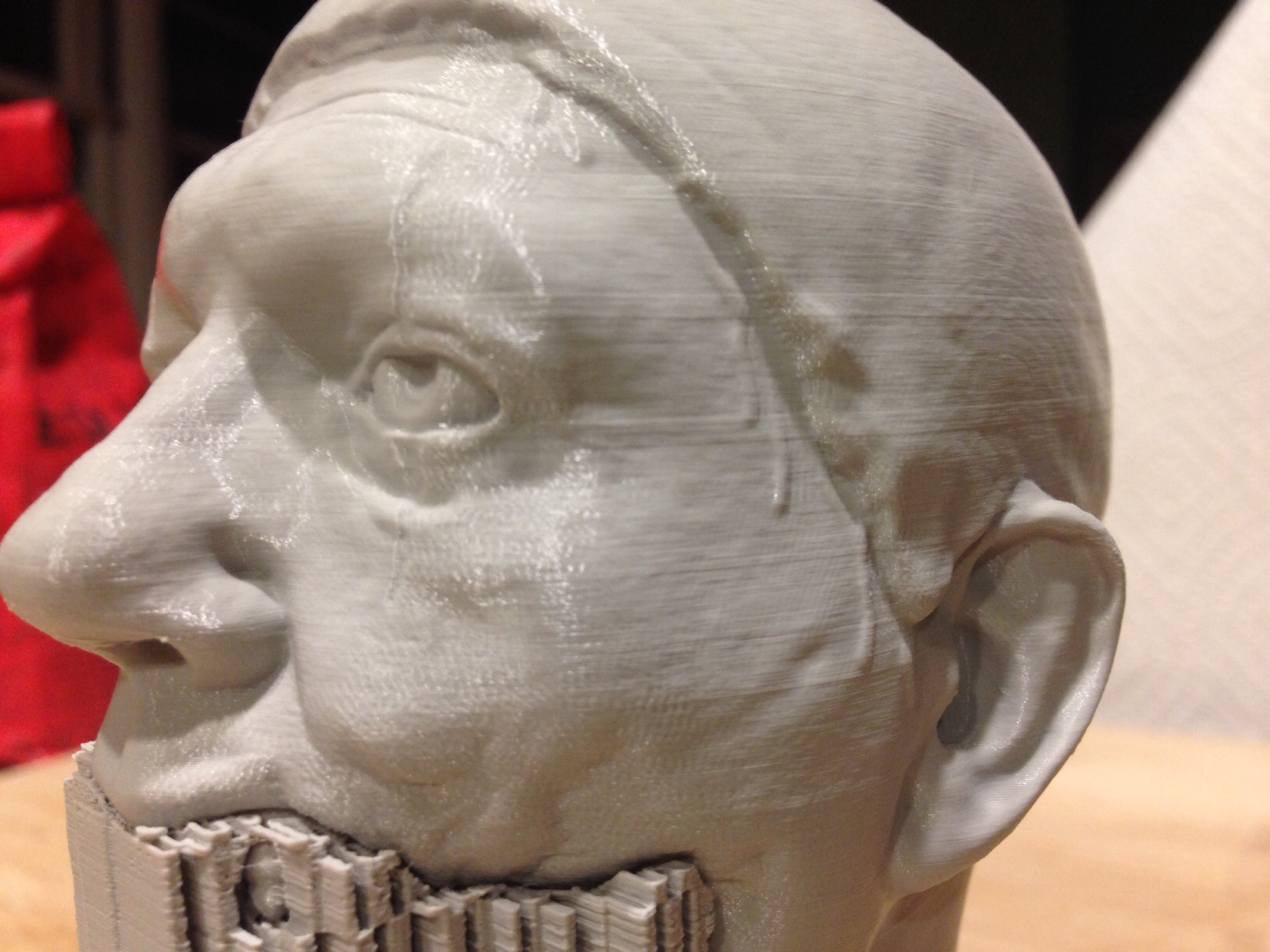

My most recent print on my Dremel (aka Flashforge Dreamer) exhibits some very prominent banding at almost exactly 7mm intervals which began about 25% up into a 5" tall print. It is much more noticeable on one side which happens to be the one nearest the end of each layer path. I had printed the same model the previous day at slightly faster speeds and didn't get these artifacts. The slower outer shell speed did reduce the ringing I was seeing in the previous print but now I have these bands which are even more annoying. Here's a photo of what I'm seeing.
Any ideas on what causes this? I've printed over 30 models on this printer and never seen this issue before now. One thing that is strange is how each band has a little raised "belt" that also seems fairly regular.
