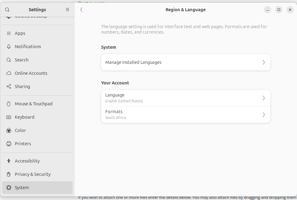

A few months back I moved over to Linux as my daily driver on my personal laptop, where I have S3D installed. But I have been unable to figure out where S3D is getting the number format from for the settings menu. All my settings in Ubuntu are set to South Africa, and when I check the language and region it shows my numbers correctly

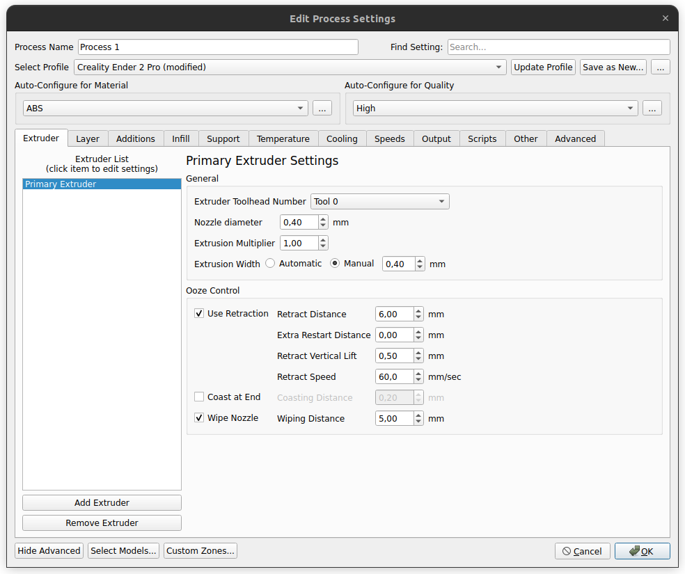

But when I open up S3D, the settings and pertaining numbers don't adopt this format
Not sure what I'm missing, but I forget this is the issue often enough to get irritated, and have tried searching the forums and haven't come across anything to guide me where to change this setting in Linux.

Yes that is correct. I have a fresh install now, running the latest version of Ubuntu LTS and same thing hey, my location is set to English South Africa, and language is set to English US, if that makes a difference. Just finished installing Simplify and location and language were setup during install.
Could it perhaps not be using the number separator opposed to the decimal point?
