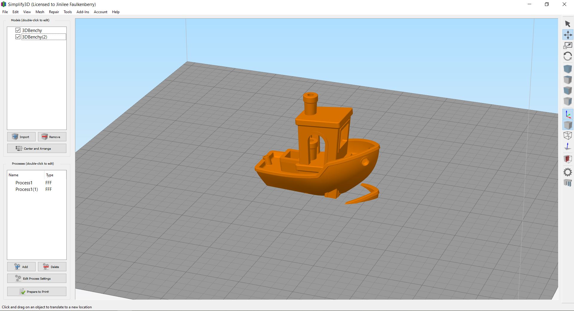

I'll try to explain what I mean better. Currently in simplify v5 hiding models is not a feature and was removed due to confusion as to what is being printed. When I am working on a project I often need to test a section of a part and sink it into the bed. In order to preserve the exact process and model position I would copy the model and hide any not currently in use.
Currently in v5 it looks like this: https://yourimageshare.com/ib/7i1qVumrll
This is messy and makes the factory file confusing to have all models shown at once. What I am asking for is the hide/show model checkbox of simplify v4 with the added feature of showing models of the current selected process.

In your example, if you select process 1 then only 1 of the models is shown in the 3D view. If you then click Prepare to Print you would suddenly see 2 models being printed for those processes. I think that is the source of the confusion. Completely hiding a model from the 3D view is different than just deselecting it like V5 currently does. It's a little more risky that you wouldn't even realize what you were printing.
Are there any other ideas that could be a bit more intuitive than models suddenly reappearing in the preview?
