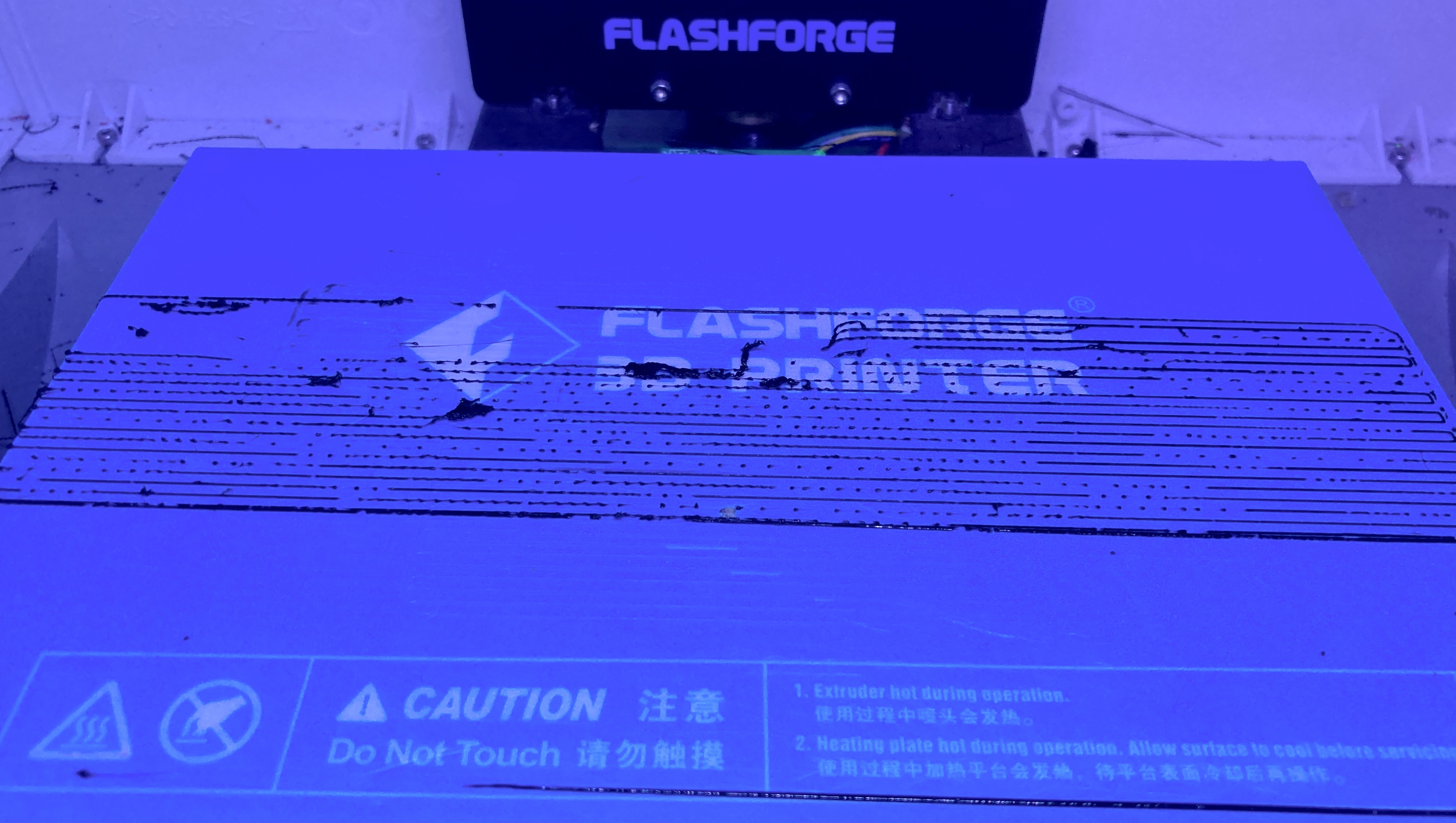

I am having problems printing the first layer of a raft on a Flashforge Dreamer. The filament layer is intermittent. I am using PLA and the first layer is set to 230 degrees. There is a decent gap between nozzle and plate. It is a new nozzle. Anyone got any ideas? I have been printing rafts successfully for years up to now.

Yes I have tried levelling the bed again. I suspect a partially blocked nozzle or a dodgy feed. When I stopped printing the raft it was difficult to remove the filament. Now it is blocked. Need to do a strip down again tomorrow. I seem to getting blockages more than I used to get.

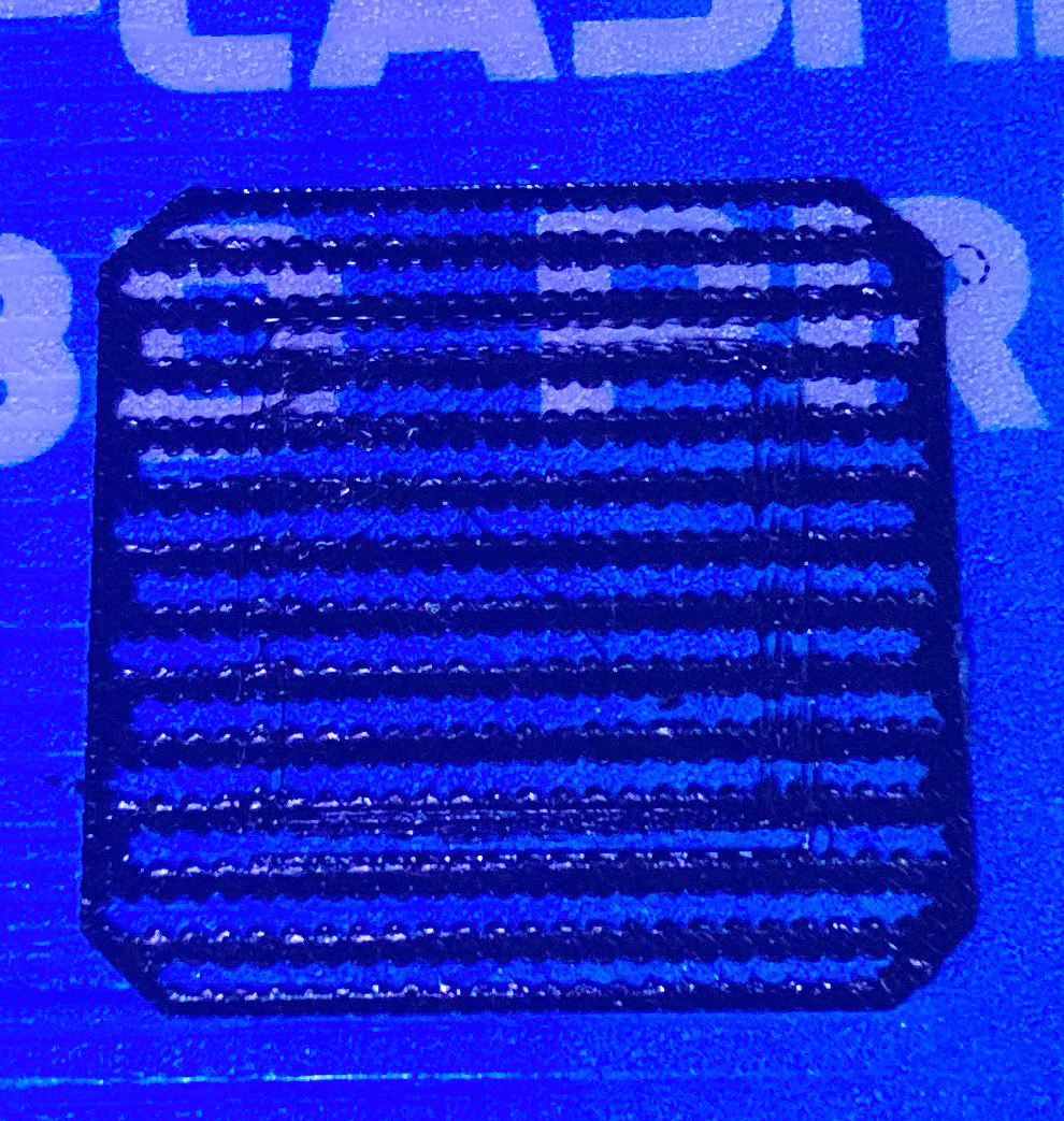

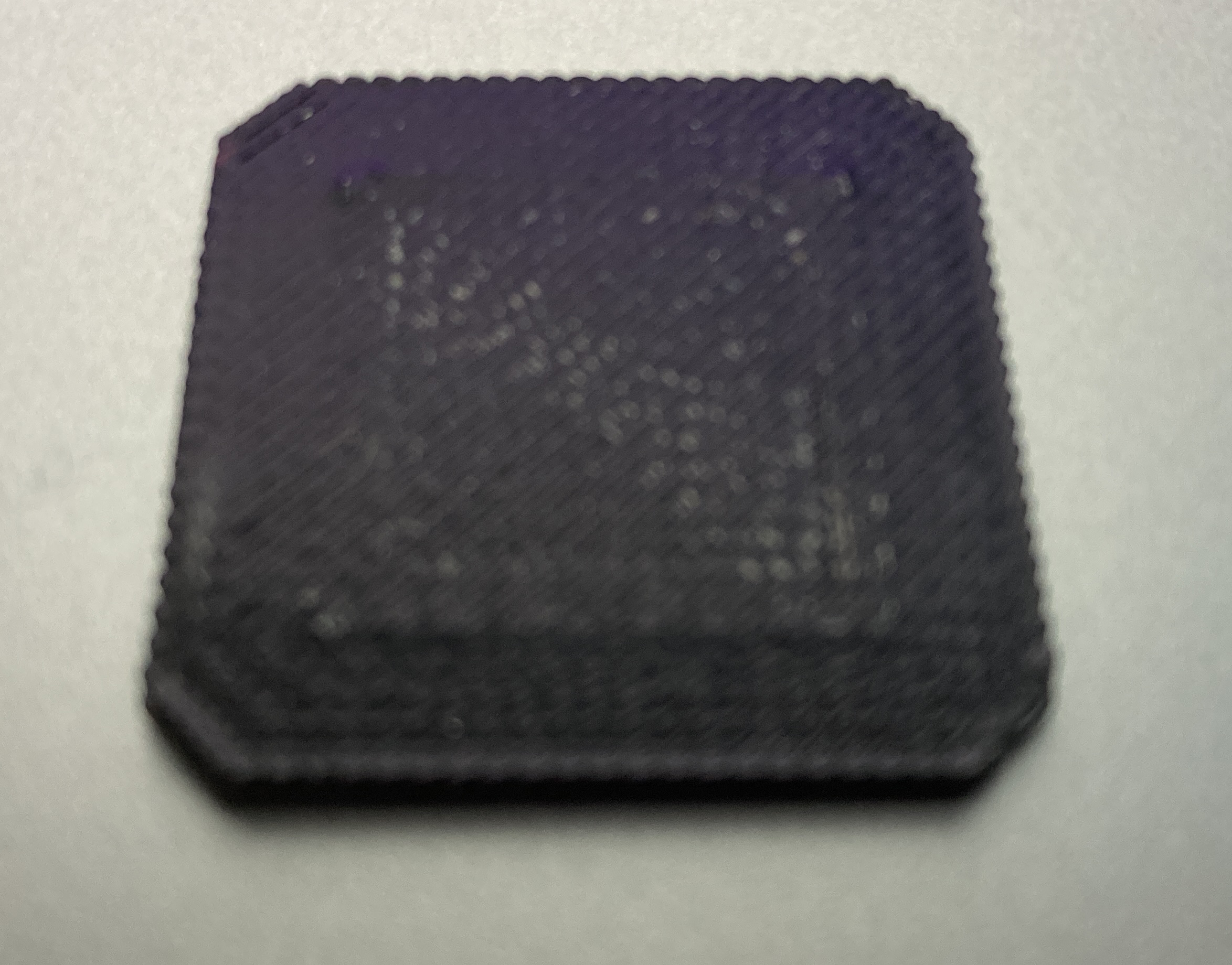

I reduced the gap between the nozzle and the bed and this cured my initial problems. However when I use Version 4 of S3D I get a perfect raft with a nice flat glossy top layer.
A bit out of focus but the top two layers have no gaps between the filaments and is a nice glossy flat surface on top of the raft.
When I use version 5 of S3D the top two layers of the raft are incomplete. I am more or less all the printing parameters I have set are the same for both versions. Anyone got any ideas what I need to change in version 5 to get a decent raft?
The raft has an incomplete top two diagonal layers.
