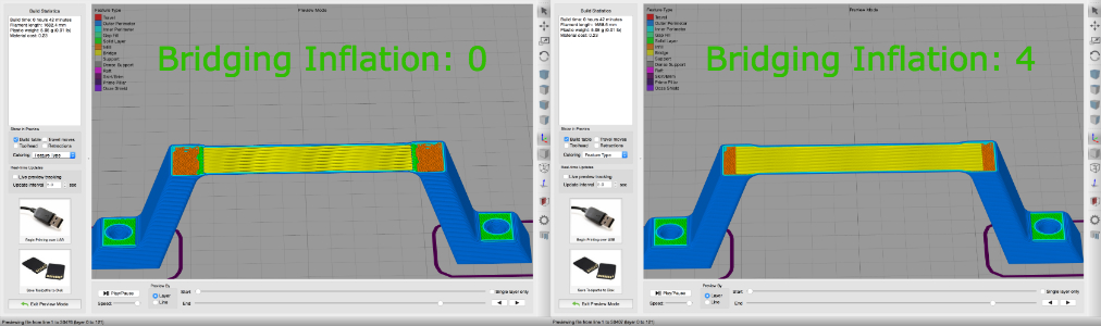

Unsupported area threshold: Any area larger than this that is unsupported will have the bridging multipliers applied to the infill in the bridging.
Bridging extrusion multiplier: If you find that extruding a lot more/less material helps with bridging, then you would set that here.
Bridging Speed multiplier:If you find that printing faster/slower helps with bridging, then you would set that here. One trick I use occasionally, is I'll temporarily set the bridging speed multiplier to 999, then slice my file, that way the areas in which the bridging multiplier is taking place are bright red and stand out in the G-Code previewer, that way I have a better idea of where the bridging settings are occurring.
